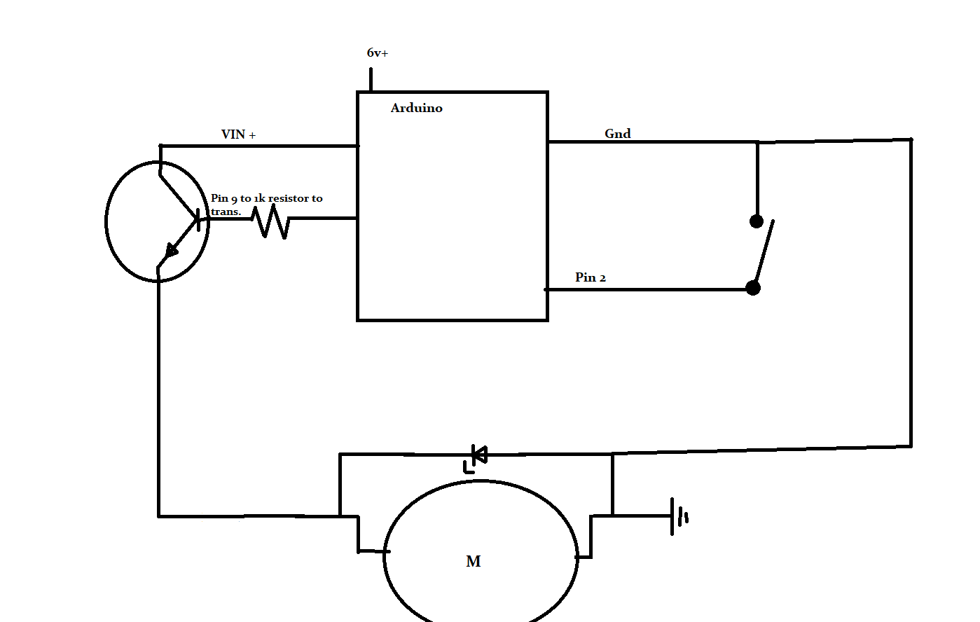

But back to Paul, I see what you mean now about having the gnd side as the switch (transistor in this case) I tried taking my existing circuit and swapping everything around backwards (in order to get the transistor on the gnd side) I swapped the diode around so that the stripe still was on the + side of the motor, kept the 1k resistor on the center pin of the transistor, to the pin 9 of arduino, etc. but now I get no movement of the motor. The transistor begins to heat up but no movement. I've tried switching to a different transistor, no luck. With the transistor on the + side of the equation it did work, albeit not 'properly' Next suggestion?
Could it be that the signal to the transistor is not adequate to run on the gnd side of the equation? Hmmm... new problem... Now if I remove from the USB and run on strictly the 6v power supply, it just keeps running continuous, I'm at 8m and counting.

Schematic please. Stop trying to use English to describe the circuit, it's too crude and ambiguous. Please start using the proper symbols, not ambiguous rectangles. Hand drawn with pencil & paper is fine.
Can I also suggest not connecting anything up until we've checked your updated schematic?
Let me know if this is any better. If there is a suggested program for creating more legible schematics please let me know. I'm a CAD/CAM machinist by trade and can draw a blueprint for a part with my eyes closed, but trying to use paint program for a schematic doesn't work that great.
Did you see?

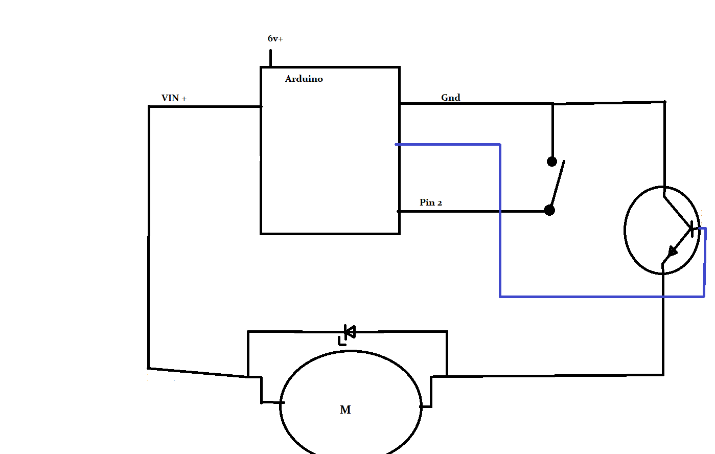

This is how it was connected when I tried to put the transistor in the gnd line path, and at the time it did nothing but cause the transistor to get hot. If this is how you would suggest I connect it I will try it that way once again and report my results. I have other transistors at my disposal as well if they would be more useful, BC557, and BC547, if either of those would be better suited to this application. I just started with the 2N2222 as that is what someone used in a video on youtube to control power to a similar motor to mine.
You have the collector and emitter pins the wrong way around, and the resistor for the base is missing.
So the transistor is in backwards? Should be like this instead?
That looks ok now. Wire it up like that. If the transistor still gets hot, replace it with another 2n2222. Don't use bc557, that is pnp not npn. Don't use bc547, it has a much lower current capability, only 100mA, which is much lower than the 600mA of the 2n2222.
