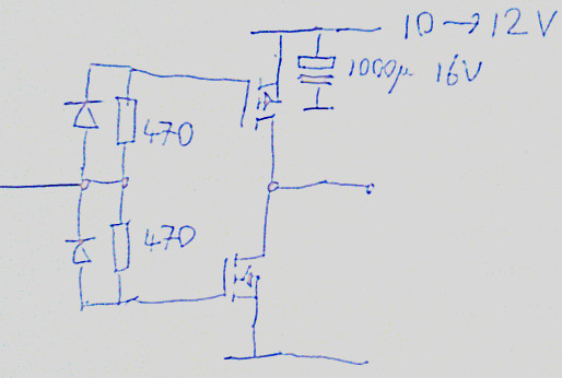

Yet another naive H-bridge circuit with shoot-through. I don't recommend using that circuit without modification.
|500x336
Note that the resistors slow down the response so high speed PWM isn't going to do well, but the devices will turn off before the opposite one turns on...
And the decoupling on the motor supply - not great to omit this, keeps the EMI down in the power wiring. Note this is a half-H-bridge only.
There are better circuits for H-bridges...
