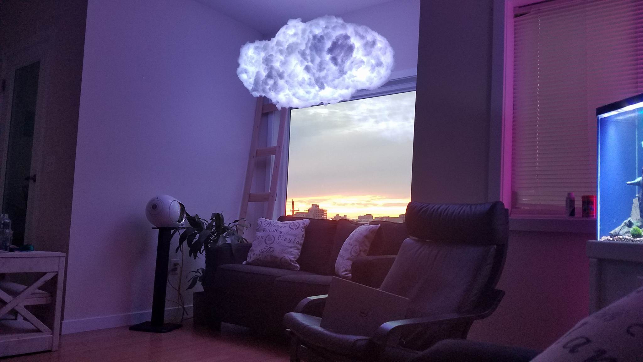

I'm working on a 5v 10a LED project which involves 5 strips fed by a 5v/10a power supply. It runs through a soldered board, with 470ohm resistors in line to each strip. There is also a 1000u capacitor to smooth things out.
The oddest thing is happening that no engineer or electrician in my circle (nor google) can seem to solve. Some of the strips flicker rapidly, except when my laptop is plugged into an outlet on the same circuit. In this test it happens to be the outlet on the other side of the room. The laptop is a dell with a 19v charger. The computer has to be plugged in and on for the flicker to stop. Note, the laptop is not hooked up to the Arduino in any way.
All connections appear to check out fine.
Plug is grounded, verified that it is properly grounded.
Multiple outlets checked.
Limited on checking a different circuit.
Lights are controlled through a BT code, all respond but the flicker persists. Rapid and consistent.
Flickers regardless of dim level, 0-100% power results in same flicker
Another power supply is on order.
Any ideas? I searched everywhere before coming here.
Thank you!

New development in trying to isolate the problem. I have a fishtank light powered by a driver that takes in 95-265v and outputs D24-45v, 1200ma. When I unplug that light the flashing stops completely.
To summarize,
Fishtank light on, Laptop unplugged - Flashing rapidly.
Fishtank light on, Laptop plugged in - Flashing less rapidly than the above
fishtank light moved to an outlet further away but still on the same circuit - Flashing but less rapid than all other scenarios.
Fishtank light off - NO flashing at all (regardless of if the laptop is powered up or not).
I tried unplugging other things on the same circuit and they had no impact.
To note, the following are all powered at the same time on the circuit:
TV
Cable box
Soundbar & sub
12 60w bulbs
55gal fishtank filter, standard light (not the high output listed above)
Speakers
Ok this fresh information seems to imply your fish tank lights are generating interference that your Arduino or strip lights are picking up.
This could be either radiated or conducted through the mains. If the latter a mains filter would cure it. If the former then look at some form of snubber circuit on the fish tank lights.
What kind of bulb(s) are on the fishtank light? I hear cfl and led can cause interference so you can try switching them out for incandescent ones if possible. And also if it goes through some kind of transformer or psu then that might be introducing the "noise".
