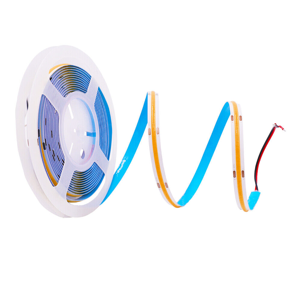

This Strip on aliexpress even seems to come with a tiny 'touch dimmer switch' so it seems a solution exists. Wont work for me as I don't think I'd have any way to mount the switch flush with the project etc but if anyone knows how it works it might help find a solution!
A cob ledstrip on AliExpress: https://www.aliexpress.com/item/1005003036736695.html
A cob ledstrip on Amazon: https://www.amazon.com/JETENCN-Density-Flexible-Decoration-Plug/dp/B0BFDY68TG
They seem to be just leds.
The "dimmer" is probably a chip with a mosfet with PWM control. You can make that circuit with an Arduino board and a mosfet.
