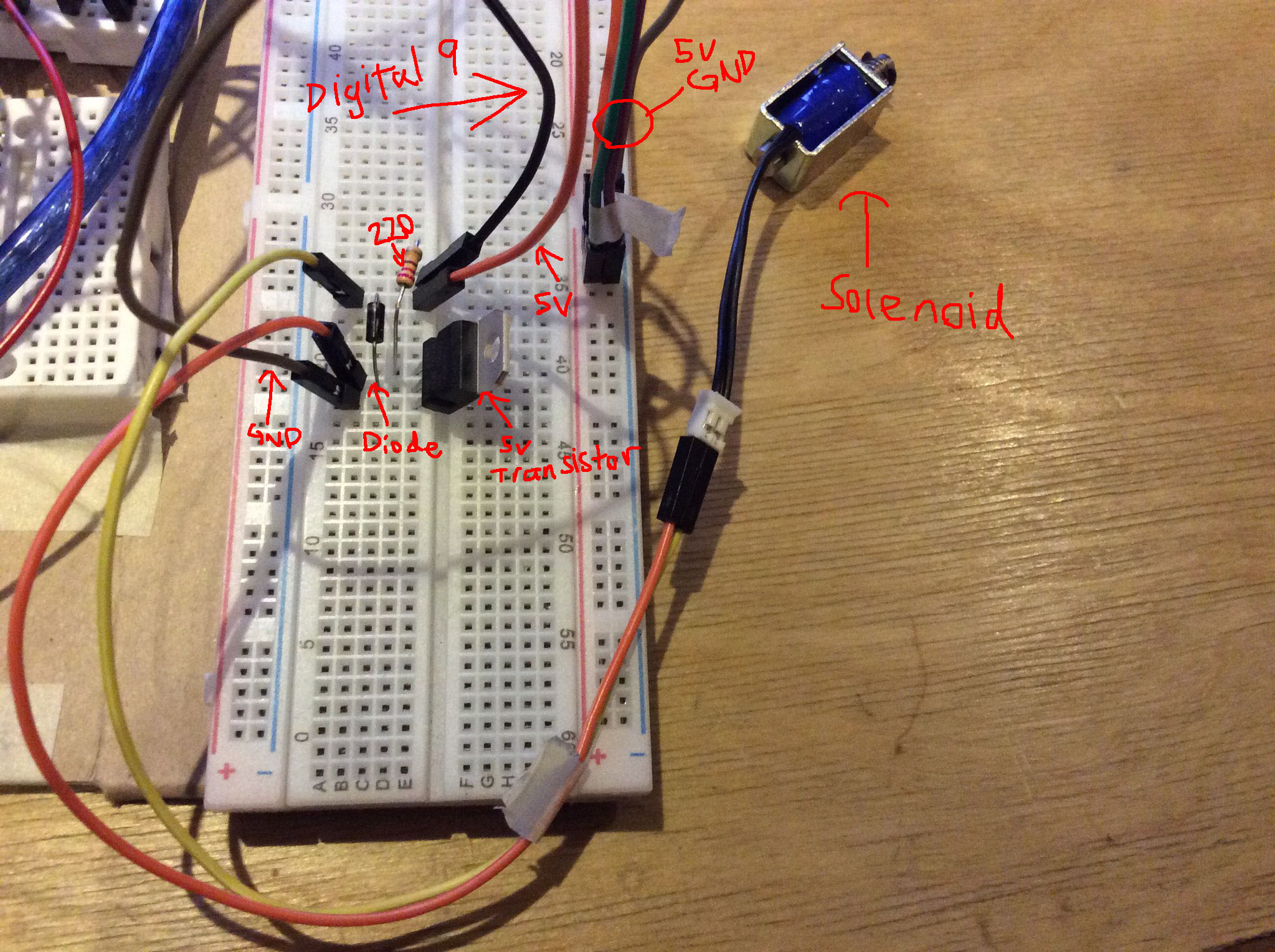

Hello.
I got a recent 5v solenoid (code and wiring done as guide here)
However, the solenoid activates regardless of connection to digital pin.
digitalWrite(pin, LOW);
Could this be an issue with the parts or something else?
Regulator: 7805/5V Regulator/TO-220
Solenoid: One used in guide above
Diode: 1N4001
There's no regulator in that guide and and you didn't mention the other (important) components like the transistor. Please provide a component list and a schematic (hand drawn and photographed is fine) of what you ACTUALLY have?

The parts were
1N4001 Diode
7805 Regulator/Transistor
220 Ω Resistor
5v solenoid identical to one used in guide
Arduino Uno
OP image. How to post images.
You cannot replace a transistor with a 7805. They are completely different parts with completely different uses.

A 7805 is not a transistor, it is an IC to regulate a supply to a "steady" 5 volts.
Steady is dependent on some additional components, quite limited and not too efficient to today's standards.
You cannot use it the way you tried.

The solenoid draws 0.21 amps
So the 2N3904 is too tight or not capable of driving this (click !), assumed your measurement is accurate.
A 2N2222 can handle 3 times as much current as the 3904, and will have some spare breath.
That will help manage the inrush current these inductive loads have (you can't measure that with a simple multimeter).
