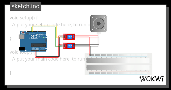

I can‘t draw it right now but I referenced this video. I just changed the relay to 8ch.

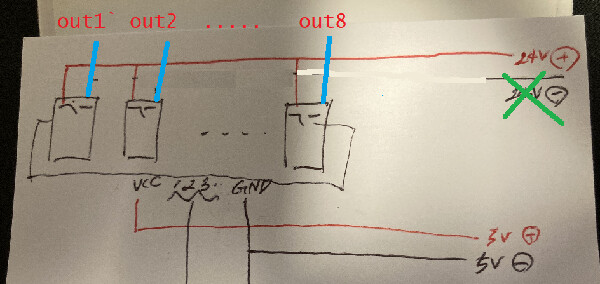

This is how I did it
Is it clear enough to understand?
*I connected actuator motors to middle output(COM) of relay. I forgot to draw them.
Sorry but imconfused.
Do you mean that I don‘t need to connect 24v - to relay?

Correct - do not run "-24V" to the relay (as you were).

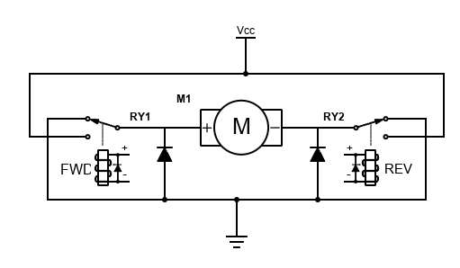

The video you linked left out an important part. The connections on the other end of the relays. It is not easily deduced. Here is the schematic form:
Sorry for the sloppy drawing. I am dealing with a tremor challenge.
I noticed I have reversed the polarity between the two drawings. Either way will work. Just exchange the actuator leads if it runs in the wrong direction.
Edited to remove oops short circuit.
That drawing short circuits the 24V supply, try again. :wink:
Can you understand this drawing? The 2 diodes suppress the motor's inductive kickback.

Are you using a bare relay, or that module? If you are using the module, connect both the "power" lines to the Arduino, +5v and GND. Then the "trigger" goes to the relevant digital pin. After that, only the positive 24v line gets switched with one relay, and the -24v with a second relay, not both with one relay. Otherwise the smoke will rise, or you'll destroy the power supply, or burn out the relay, or blow your breakers!!
yes they do have limit switch
you mean that 24v + to the first channel and 24v - to the seconds channel?
But then how can I change the direction?
So..then no 24v - to NC terminals.

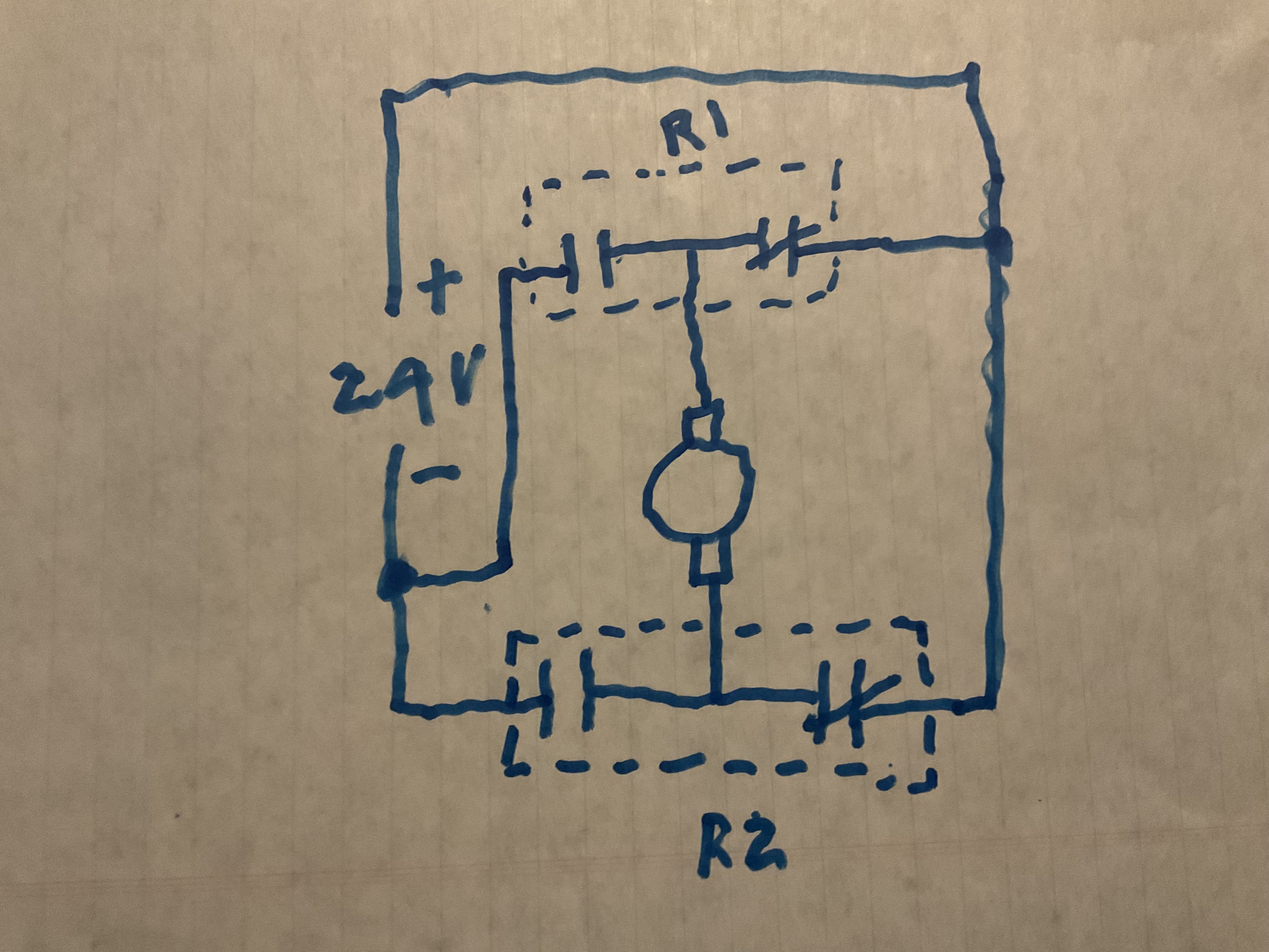

Very easy.
Look at this "schematic". This will switch polarity (to a motor for the sake of the example)
