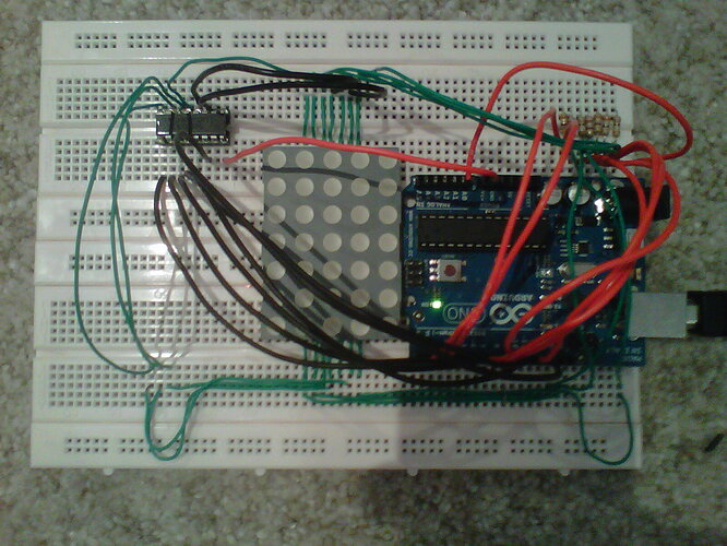

5x7 LED Matrix Issue
there are 7 pins on each side of the LED matrix..
The pin numbers I gave above correspond to those 14 pins.
I have built the circuit but the matrix is not working correctly
could you take a look and see if i have made a mistake.
(the resistors are not connected on purpose, was checking if they were limiting matrix too much. BUT are connected during tests)
The results are slightly dim LEDs slightly brighter LEDs, some off.
We need to know exactly what it does and what you expect it to do.
Pin 1 on the ULN2003 is the lower left corner?
Looks like you have 6 outputs wired up? While there are only 5 cathodes?
Same with the display - pin 1 is lower left? Any chance its just flipped?
How about posting the code you are running?

when i execute that code, this is the result:
I would expect from that code that all the LEDs should be off. What do you expect?
As all the LEDs are not off then you have wired it up incorrectly.
Sorry, that picture is from when i changed the code for all pins to be HIGH, it is the only thing that makes a difference to the matrix
Well if all pins are high there should be no LEDs on either so you have still wired it up wrong.
I wired it up as you said with all the corrEct pinouts.
You think you have but you have missidintified something.
What is needed is a schematic of what you are trying to acheave, not the sort of thing you have been posting so far and then a clear photograph of what you have done, along with the code you actually run not something like it.
Otherwise how else can we identify what you have wrong.
