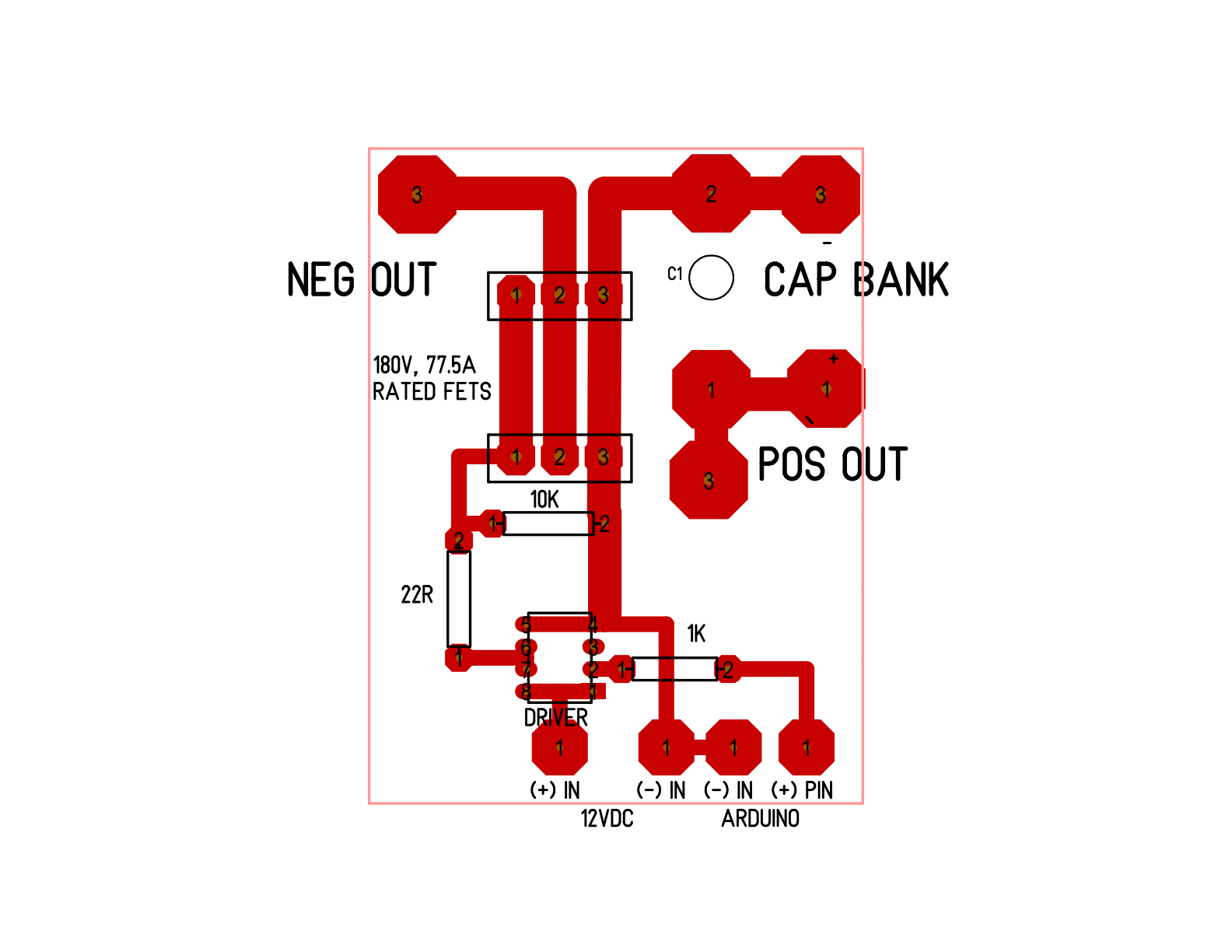

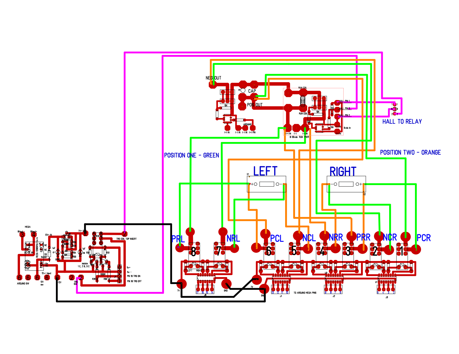

It's your copper, leave as much on your PCB as possible, ie, the 77A tracks.
Now we need a schematic.
Tom..
