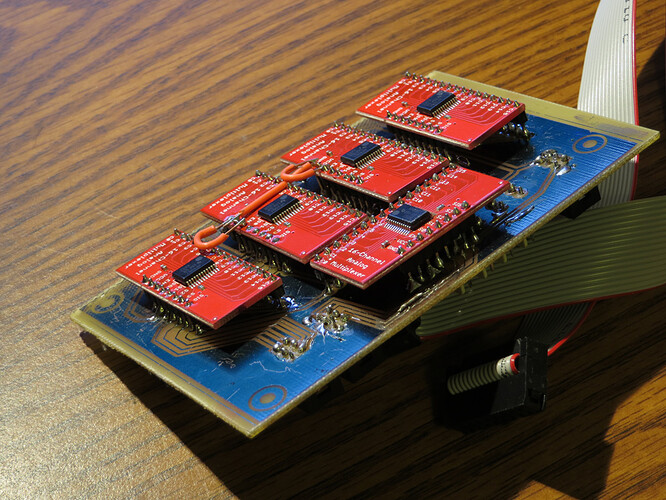

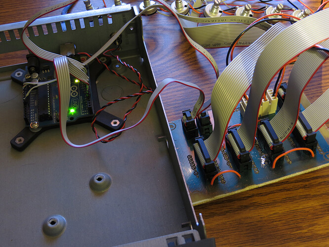

Knobby knob midi controller project prototype number 2. 64 knobs working smooth as eggs. Refined the code a bit to achieve said smoothness and accommodate new multiplexing board I built that handles the 64 knobs (256 knobs is possible with this design, but that's just crazy). Multiplexing board was built from scratch by designing circuit layout with CAD -- printing layout onto transparency paper and exposing and developing light sensitive board with pattern. This one was really rough, but honestly super surprised it worked on first attempt. Next step will be coming up with ideas for a nice enclosure.
