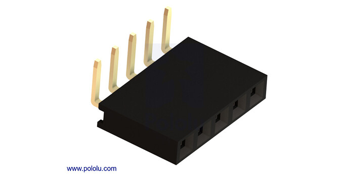

I buy bare PCBs from itead studio, probably order 50 of them for $45, will sell 18 to you for cost plus share of shipping to me and then shipping to you with 2.39% paypal fee.
You order your own connecters, caps, headers, etc. as needed and assemble.
I can also do complete boards if you'd rather, need to add cost of material & assembly time.
Would need your input on headers desired, or just holes, etc.
