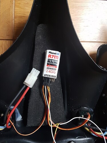

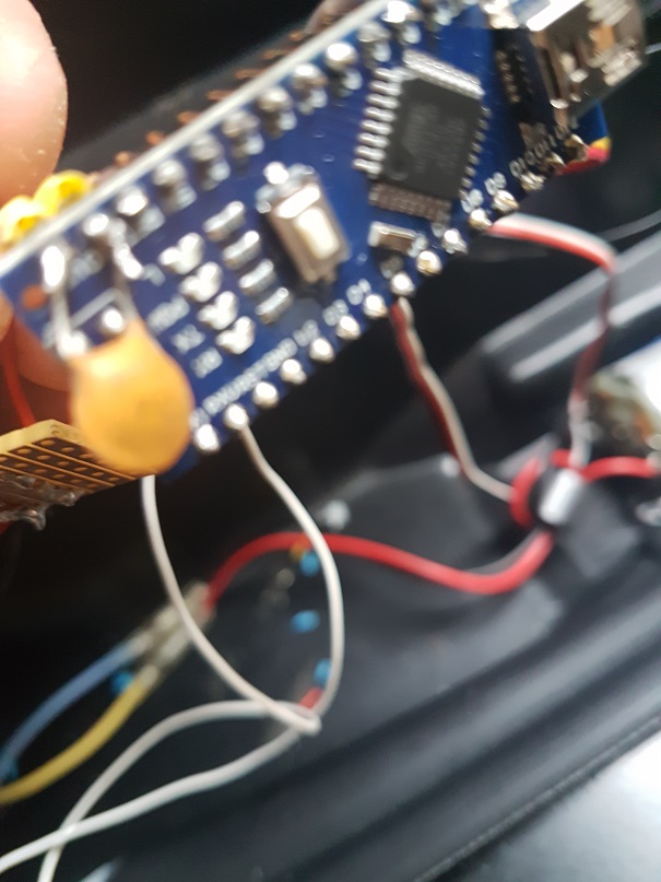

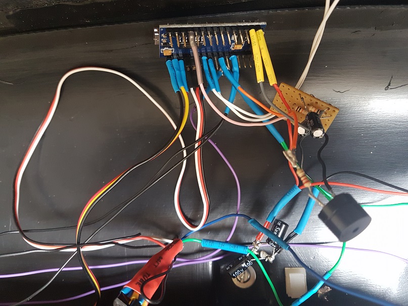

Right Daz,
Am struggling tonight to get a full schematics drawn up as my software is pants.
What i'm trying to do is use the Arduino-
  1. control main lights 3 x leds i've manged to do this via some resisters and BC547B.
  2. Hopper lights 4 x flashing leds again mission complete (resisters and BC547B)
  3. Power up buzzer tone ( a few bleeps when you switch on) Job done (happy)
  4. Battery monitor TRI led, green for fully charged, blue for half charged and red flashing to changed the battery) and wired via the voltage divider as my crap drawing).
Battery Monitor does work but problems fluctuating when motors are going (under load Multi meter reading 5.6v)
While toggling the transmitter for the motors to turn it resets the arduino and sometimes switches the hopper light on or the main lights..( BUT improved since i've put the caps on)
The motors are powered via 2 x ESC's these are connected straight to the power switch and the ESC's power the receiver R7M.
I've put 2 x 4.7uF caps and a flyback diode near the switch to power the arduino and a 0.1uF ceramic soldered to the pins VIN & Ground ( the 4.7uf is all i had kicking about think bigger ones might help but dont know what size to order).
So.. from what your saying daz the battery monitor wont work because the battery is going under load making it drop below what i've set it to in the code.
Now what i thought is maybe i put up with it, but try to make it a slower transition between the colours, the monitor leds dont have to be precise just indication. maybe a delay i could put that in the code BUT i dont want the code to be pausing while its doing this delay. would some caps do the job?
Well i think that where i am with it.
PS.the Battery monitor tri leds are powered off the arduino via resisters.
You can see i'm not trying to link to NASA its just a few leds.
Here's some pictures the wiring is a but rustic while i'm prototyping.
Kev

Here are your pictures.
