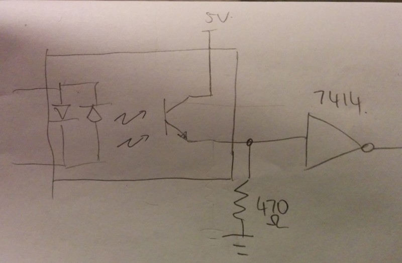

I am driving a 7414 Schmitt Trigger from a PS2505 optotriac I have a 120VAC switch coming in to the PS2505, the output of the PS2505 going to a 7414 Schmitt Trigger and the Schmitt output going to an Arduino input pin.
I have triple checked that I have 5V at pin 14 and GND and pin 7 of the Schmitt. I ave also swapped out the 7414 for another one with no change

I have attached the relavent datasheets and a schematic of the section

I'm not sure your hookup to the PS2505 will work. Try grounding the emitter, put a 4.7K resistor pullup on the collector and feed the 7414 from the collector.
For a regular TTL chip you need ~470 to GND on an input to guarantee a low. On LS TTL 1.2K will work.

Based on what you have both suggested I have drawn a new schematic (see Schematic#1 attached), however if I am correct there is a voltage divider between the output of the PS2505 and the input of the 7414.
If that is the case, should I do something like schematic#2 attached ?
Or should I do something else entirely?
Number 2 has the proper placement for the 470. Number 1 should work also, but you would not need the 470 in that example.
Number 2 |500x326
Number 1 |500x178
Number 1 is also an inverting output in relation to the input, if that matters any.

It looks to me as though the circuit in question is meant to be a zero voltage detector for use in a phase controlled power controller.
If that is the case, (and as far as I can see that has not been mentioned yet in this topic), then I think that there is a major problem with the circuit.
Using a capacitor and resistor to drop the voltage to the LEDs is going to give a phase change to the current through the LEDs. (I know you have done it to reduce power dissipation in the circuit as a whole).
Using an on-line calculator, it looks to me as though there is a 72° phase difference between the current through the LEDs and the main current. As far as I can see, there will always be this 72° offset.
The calculator also suggested an impedance of around 8.3kΩ, I'll discus the implications of this in my next post.
