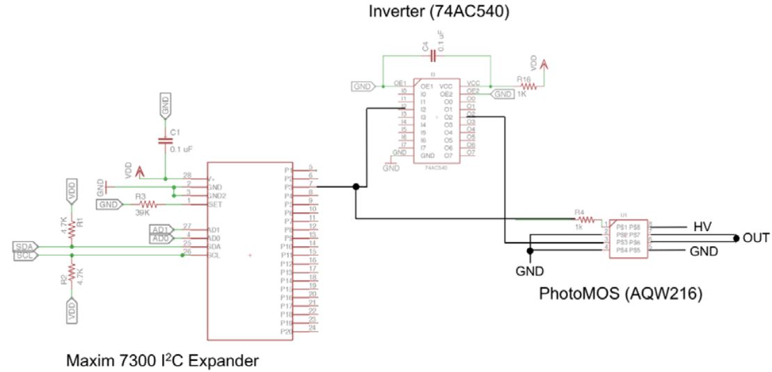

I used 74HC595(shift register) as a IO expander, and 74AC540P(inverter) to switch the optoisolator. But here is the problem, the shift register can not work correctly. For example, i sent 0x05 to shift reg, the bit 5 and bit 6 is ON.(sent 0x04, bit 4 and bit 5 is ON, and so on.Alike problem)
I connected UNO 5V pin to Vcc, but L led looks dim(Not enough power?). So, i connected UNO Vin pin to Vcc. Also measured 74HC595 & 74AC540P Vcc to gnd voltage is 1.1 Volt, so i think is the problem. How to fixed this problem? Or other bug cause to this problem?
Plz help me, thanks.
PS-the attachment is circuit diagram.

OP's cct.

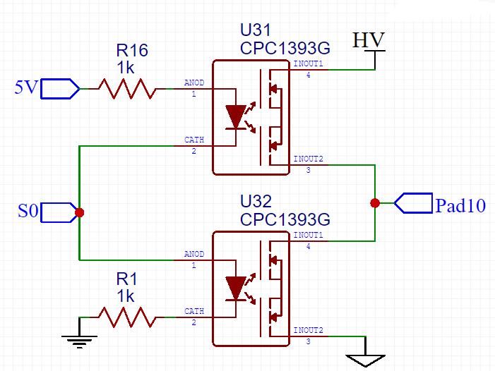

Why the inverters.
The 595 can source and sink, so can drive both opto LEDs.
One resistor/LED between output and ground, and one resistor/LED between output and 5volt.
You might however need separate timings for both (slow, 5ms) optos,
becasuse of possible shoot-through (both being 'on' at the same time).

Because i want use a bit(an IO) control a pair of opto act like flip-flop(output HV or HV_GND).The circuit took reference from here(support info have circuit diagram). According to above ref, i think the switch time is fast enough to prevent shot-through (not try yet).

Your diagram:
You can totally do this without the inverter... by placing the INTERNAL OPTO LEDS in opposite polarities across each other.

r u said like this?
And i found the problem, i forgot add limit resistor in inverter Vcc. After add resistor is work like a charm!
