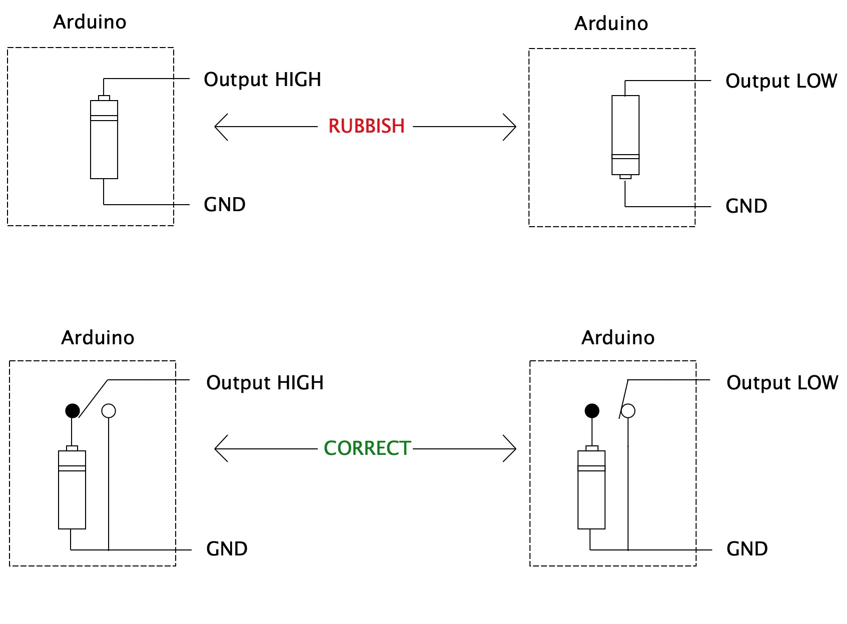

It was the best "simple" explanation I could think of.
Pity you couldn’t come up with an explanation that is actually correct, because you can’t actually get a negative voltage out of a pin.
I assume the person who “told” you to do this knows absolutely sod all about the topic. This is what is wrong with education these days.
See if this gives you a better idea about how to think of this

@Grumpy_Mike
Not sure what you mean by not correct. I get that pins cannot give a negative signal in the sense that they only go from ground to 5V, but really potentials are arbitrary. I could say that ground is now -5V and 5V is now 0V and the physics would work out exactly the same. That's why when communicating between 2 devices a ground connection is necessary for them to work from the same ground right? What matters is the potential difference.
And the people who told me to do this are software engineers who by their own admission know very little about circuitry. They do own the business though, and I'm just an intern so not much I can do about that.
Also, you seem a little angry. Did I break some etiquette? As you probably can tell by my profile, I don't usually post on forums. Then again, I can't really read tone or body language from text so maybe I'm imagining it. Or maybe it's coz your username has the word "Grumpy" in it. :slight_smile:
I mean wrong, incorrect rubbish, crap.
No they are relative not arbitrary,
Correct.
Correct
Correct, but those statements do not and can not apply together. One of the worst cases of muddled thinking I have come across for a long time.
Yes I am angry that you think you are smart enough to be let loose on 10 year olds to try and teach them rubbish. And I am angry that the people telling you to do this know are so ignorant that they don't even consider what you are trying to teach is important.
You are depriving them of any understanding and just giving them a pile of arbitrary facts to learn with no foundation at all.
Look at this diagram.
The top two are what you are trying to teach, and the bottom two are what you should be teaching.
@Grumpy_Mike
Yea, I meant arbitrary starting point. Good catch.
The 2 statements HAVE to apply together right? Otherwise the potential difference changes.
Yea, I understand why you think the analogy is so bad now. You think I'm telling them that the polarity can be flipped. Not really, coz i teach them to treat ground as negative as well.
And yea, I DON'T think I'm smart enough to teach circuitry accurately. I'm still an undergrad and I don't even study engineering, I study physics. But the point is not so much so to teach circuitry but rather spark enough interest so that they learn it in detail by themselves through Googling. Sure they'll end up with misconceptions, but through experimentation and breaking electronics they will learn over time.
