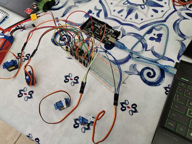

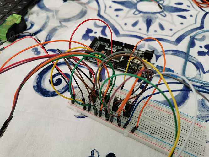

Today I found a new problem. The servos are getting powered by the LiPo, so I added more and more servos. After I added the fourth servo, they started quivering. If I connected the most quivering servo with a voltage messuring device they all stopped quivering and moved as supposed to. Now I'm not sure if I need some capcitors or something else (for example resistances). I searched on the internet, how the messuring device works and it seems to have an inbuild resistance.
Do you still have a 7805 for each servo? Does each 7805 have the 2 capacitors it needs? What is the specification of the LiPo (voltage, capacity and C-rating)? How is everything connected together (NOTE - through a breadboard is the wrong answer!).
Steve
Can you please post a picture of your project ,so we can see your component layout?

It is the same circuit as before, just with the GND to the Arduino and with 4 Servos. I hope you can see something on the pictures.

Ah right, thank you. I tried to achieve better visibility for the picture and therefore stretched it :grimacing:
When I saw the problem the cable was connected right.
The Servos still quiver. I think I need the capacitors but I don't know, which specifications they need. Is the stated voltage in the product describtion the maximum of voltage he can sustain or is it his voltage output?
