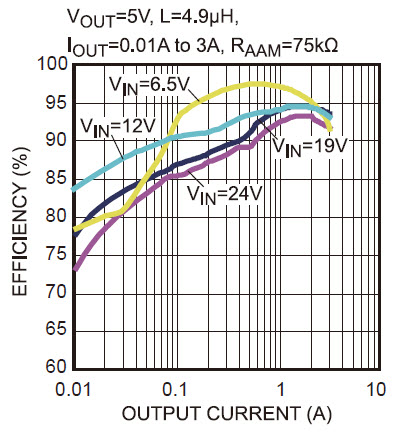

Efficiency plot from the "full article" linked in the above post:
