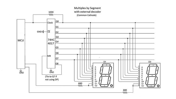

Not designed specfically for that purpose, but if you mutiplex by segment, and if you use common cathode displays, you can use the 74HC4017 to drive the segments. You would need a processor pin for each digit, plus one pin to clock the 4017. So 5 processor pins for a four-digit display. You would also need a resistor for each digit, but no transistors. See the attached pic of a two-digit display as an example. The concept is discussed in this video:
[https://www.youtube.com/watch?v=8w09Zy8MQrc](https://www.youtube.com/watch?v=8w09Zy8MQrc)
 ![External decoder](https://europe1.discourse-cdn.com/arduino/original/4X/c/4/f/c4ffa2cb8dc9b1edbb7dcbfcfeb4c6581b883f2a.jpeg)

The problem with that arrangement, is that it puts illuminated segments in parallel. So "1" which has only two segments, is brighter than "8" which has 7 segments. Even segment illumination depends on current limiting per segment, not shared. So, a resistor for each segment.

I don't think that's accurate. Since it's cycling through the LEDs one by one, there will never be more than one segment active simultaneously.

I was referring to ShermanP's example, which uses a 74HC4017 decade counter instead of the 74HC595. Interesting to hear you coded a solution to get similar results from a 74HC595 though 😮

Oh, I get it now. That would work. You would need more digit lines though, if you have more than 2 digits in the display...

> [@anon57585045](#):
No, the same current always flows through each segment no matter how many digits are lighting up that segment. The resistor on the common collector sets the current since only one segment is selected at a time.
> [@calciumphysalia](#):
> Oh very interesting, thank you for sharing!! I worry that approach will show noticeable flickering (you can see that in the video, though probably due to the camera), but I'll consider it!
I don't see any flickering in the video. In any case, there was no flickering when viewed live. In any case, you can always refresh more frequently if you like. Notice that the refresh rate does not depend on the number of digits since it's the segments that are multiplexed. But the refresh rate will be faster than multiplexing by digit because each segment is on only 1/7 of the time rather than 1/4 of the time.
This method is supported by the sevseg.h library, but I don't think that includes the 4017 part. But the Github repo associated with the video has 4017 code that doesn't use a library.
The other consideration is that since no transistors are used, the 4017 has to be able to supply enough current to drive four segments at a time, as determined by the common collector resistors. This is more likely to work if your seven segment displays are super efficient, as discussed in the video.
If parts count and pin usage are important, I think you'll find that this method is about as good as it gets.
<div class="post-metadata">

> [@johnwasser](#):
> There are chips like the MAX7219, designed for 8-digit 7-segment displays
Which you can chain endlessly to have even more digits
**Author:** ![TomGeorge](https://dub1.discourse-cdn.com/arduino/user_avatar/forum.arduino.cc/tomgeorge/32/215261_2.png) [@TomGeorge](https://forum.arduino.cc/u/TomGeorge)\
**Post date:** [August 28, 2021, 7:45am UTC](https://forum.arduino.cc/t/a-better-way-to-control-a-7-segment-display/899591/20 "2021-08-28T07:45:49Z")
</div>
Google
> max7219 4 digit 7 segment
There are many examples and sellers with ready made modules.
Tom... 😃 👍 ☕ 🇦🇺
