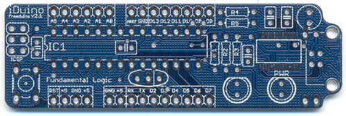

A box of these arrived from the PCB fairy this afternoon.
The design started out life as the Freeduino Through-Hole design and was hacked and squished until it fit into a vaguely DIP like form. At that point it was starting to look like a Boarduino, so I swapped two pins and ended up with the same pinout. They then spent 5 weeks in manufacturing and shipping (I'm cheap), and now they're on my work bench.

Yes, kind of. Still waiting for the resonators to come in, so one has been tested running the Lilypad bootloader. Everything appears functional and the layout is viable.

Is that a capacitor I see on top of the AVR chip?
How on earth does that work?

The cap must be under the IC. Now that I see his populated board it looks like he is using a socket which would have plenty of room for an SMT cap and more.
If this is the case, very clever!
Nice design!
The cap is indeed inside of the socket. In this case though, it's a very tiny PTH cap (same as the blue ones used around the socket). The pads are large enough to mount an SMT cap in there if the socket is much shorter, or underneath if you don't use a socket.

I like it, and I would buy one except that it uses a resonator rather than a crystal. I hate that I have a decimillia tied up in my clock, but pretty much all of the cheaper boards won't work because of they use resonators
Hmm, in this case, a resonator is used due to a lack of space. If you were dedicated, a HC-49US sized crystal would certainly fit the layout, and two small caps could be soldered between it's legs.
Certainly some of 'the cheaper boards' do use crystals, I know NKCElectronics uses crystals in some of his Freeduino kits. My own MaxSerial board supports a crystal, and I'd be happy to substitute one in on request.
