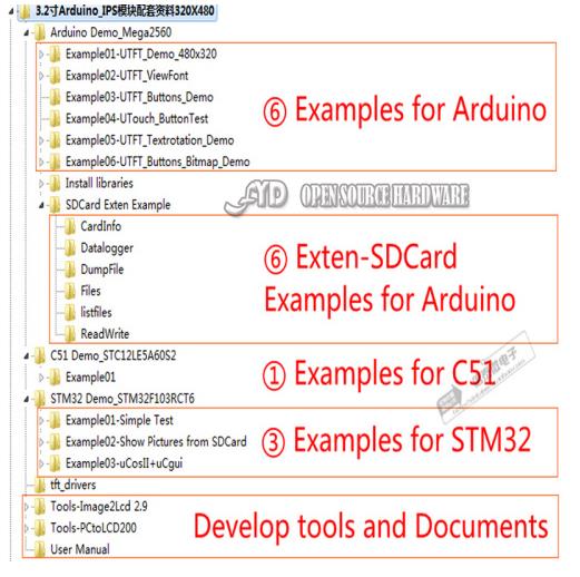

Do you know what tutorial they are talking about here?
aliexpress.com 3-2-inch-TFT-LCD-screen
VT91:
It's a list of libraries, some native in the arduino IDE, some 3rd party.
