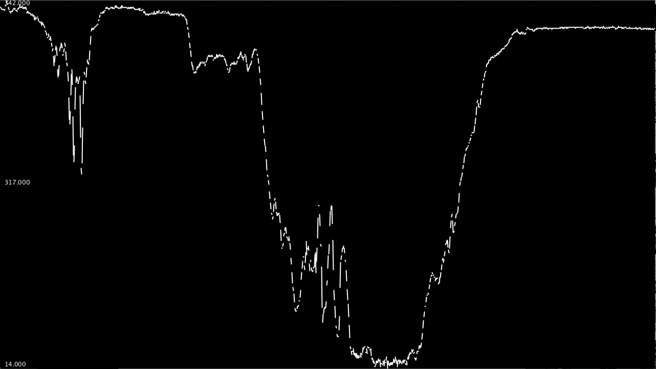

I don't have processing installed, can you show some screen shots and maybe a simple Arduino sketch.

You really ought to get Processing, not just for your Arduino - it to computer programming is like the Arduino to other microcontrollers; it makes it a whole lot easier and simpler and takes the gritty work out of it. And, it is of course free.
Unfortunately, steep lines don't turn out so well in the screen shot. I'm just using a simple LDR hooked up to my 'duino.
