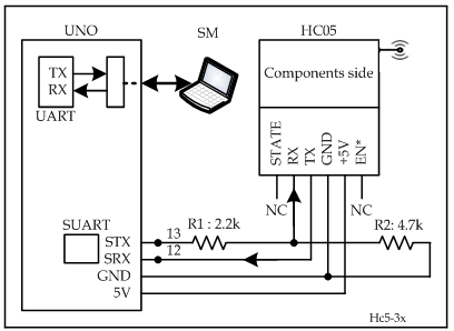

@OP
If you are really seeking help, please answer to my questions with respect to the following codes taken from your loop() function:
if (Serial.available() >= 2)
    unsigned dataIn = Serial.read();
    unsigned dataIn2 = Serial.read();
    val = (dataIn2 * 256) + dataIn;
    Serial.println(val);
1. Are yo testing your codes using Serial Monitor -- Yes/No?
2. Are you testing your codes using Android Smart Phone -- Yes or No?
If yes, connect your Bluetooth Module using a Software UART Port (SUART Port) and leave the Hardware UART Port with the Serial Monitor for debugging and uploading.
(1) Make connection as per following diagram.
Figure-1: Connection between BT and UNO using SUART Port
(2) Include the following lines in your sketch to create SUART Port.
#include<SoftwareSerial.h>
SoftwareSerial SUART(12, 13); //SRX = DPin-12, STX = DPin-13
SUART.begin(9600);
3. You are creating val (unsigned 16-bit) from dataIn and dataIn2 which are coming from your Smart Phone. Are they coming as charcaters (ASCII code) or binary value? Is it A (01000001 ASCII code for example) for dataIn and B (01000010 ASCII code for example) for datIn2? Or, is it A (00001010 binary value for example) for dataIn and B (00001011 binary value for exmple) for dataIn2? What is the BT Terminal setting of your Smart Phone -- is it in ASCII or HEX? The answers are need to adjust the codes that I have quoted above at the beginning of this post.
4. Assume that the BT Terminal of your Smart Phone has the HEX setting, then you are receiving two data items from the Smart Phone to create the 16-bit value of val. If so, the following codes are logical considering SUART Port.
byte n = SUART.available();
if(n >= 2)
   byte dataIn = SUART.read();   //what is unsigned dataIn?
   byte dataIn2 = SUART.read();
   val = (unsigned int)dataIn2*256 + (unsigned int)dataIn;
   Serial.print(val);     //shows as decimal value
5. You have declared and defined this function drills(); but, you have never used/called it in you program. What is the need of this sub-program?
6. To get a value of 1100 for your variable val, what are these two bytes data you wish send from your Smart Phone to UNO? Remember the formula for val --
val = dataIn2 *256 + dataIn
Awaiting for the answer and then I will continue with my nest queries/questions in this post?
