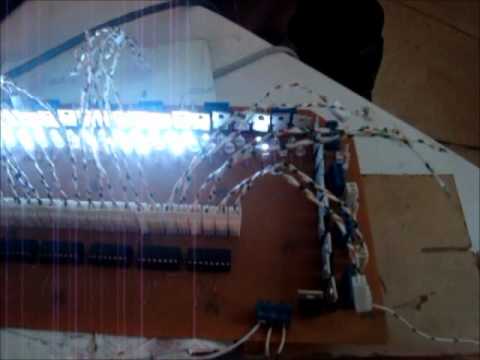

The hardware is almost complete. I am using 40 Solenoid valves 24VDC 260mAmp.
Here is the PCB sketch where i am using Qty:05EA shift registers 74HC595 and the PCB also serves as a simulator with 40 LED installed. The PCB also contains 40 IRF540 to drive the solenoid valves.
Here is the completed PCB:
and here is 6inch diameter PVC Header pipe with 40 drains dia 8mm each. The Pipe also have connections for inlet / outlet of water supply.

Today i did wiring work from solenoid valves to microcontroller. ... lets see whats happen... I know the wiring is not organized so dont point ]:smiley:

This is first test of graphical waterfall consist 40 solenoid valves. All the things working fine but the graphics are hardly visible due to:
1- I have long tubing downstream the solenoids...If small metallic nozzles directly connected to the solenoid i would have got good results.
2- The Height of the solenoid. The solenoid are installed at about 8feet height, i think to see the graphical effect it must be 20 feet or above.
Any comments to improve will be highly appreciated:

Hello, I think you have done two mistakes, first you have not placed solenoids on the same level ! and the second is that you have redirected water from solenoids with long pipes, the plastic valves distort the image. remove the pipes after solenoids and place the solenoids on single line !
where i can get this awesome software ?
Very interesting project!
I'd agree with the assessment that the long thin hoses right at the outlet of the solenoid valves absolutely kill the whole idea. What you are trying to achieve with the hopefully very fast solenoid valves is essentially a pulse width modulated signal. The hoses work like a capacitor of sorts, filtering your nice clean signal edges.
Once you've done that it may still not work as you may need more height than a door to form a pattern.
Also a dark background and some back lighting ore better strong side lighting (perhaps recessed in the door frames) would make these water lines more visible.
