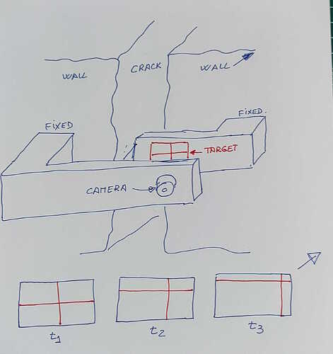

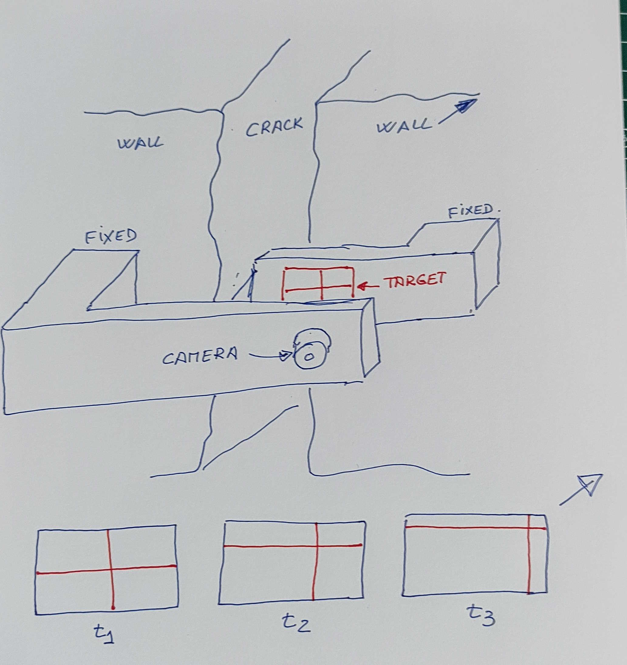

I'm designing a micrometer crack sensor using an Arduino and a camera. The camera is attached to one side of the crack, and a target with a very fine crosshair is attached to the other side. By taking several successive photographs of the target and identifying the different positions of the center of the crosshair (X, Y positions), we can determine the pixels that have shifted relative to each other on both sides of the crack.
I need a camera and a routine that identifies the center of the crosshair (X, Y) from a photo taken with the camera.

The idea is to fix a camera on one side of the crack, and a target with a cross on the other side of the crack.
A photo is taken of the target with the cross, and the X, Y point of the cross is searched for. If in successive photos the central point of the cross moves, it indicates that the crack is opening or closing.

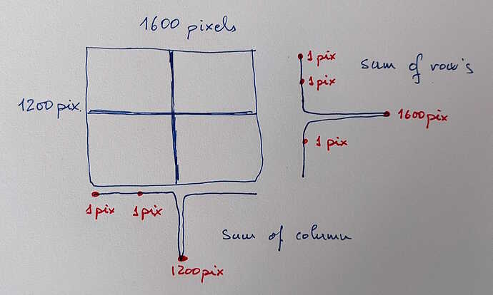

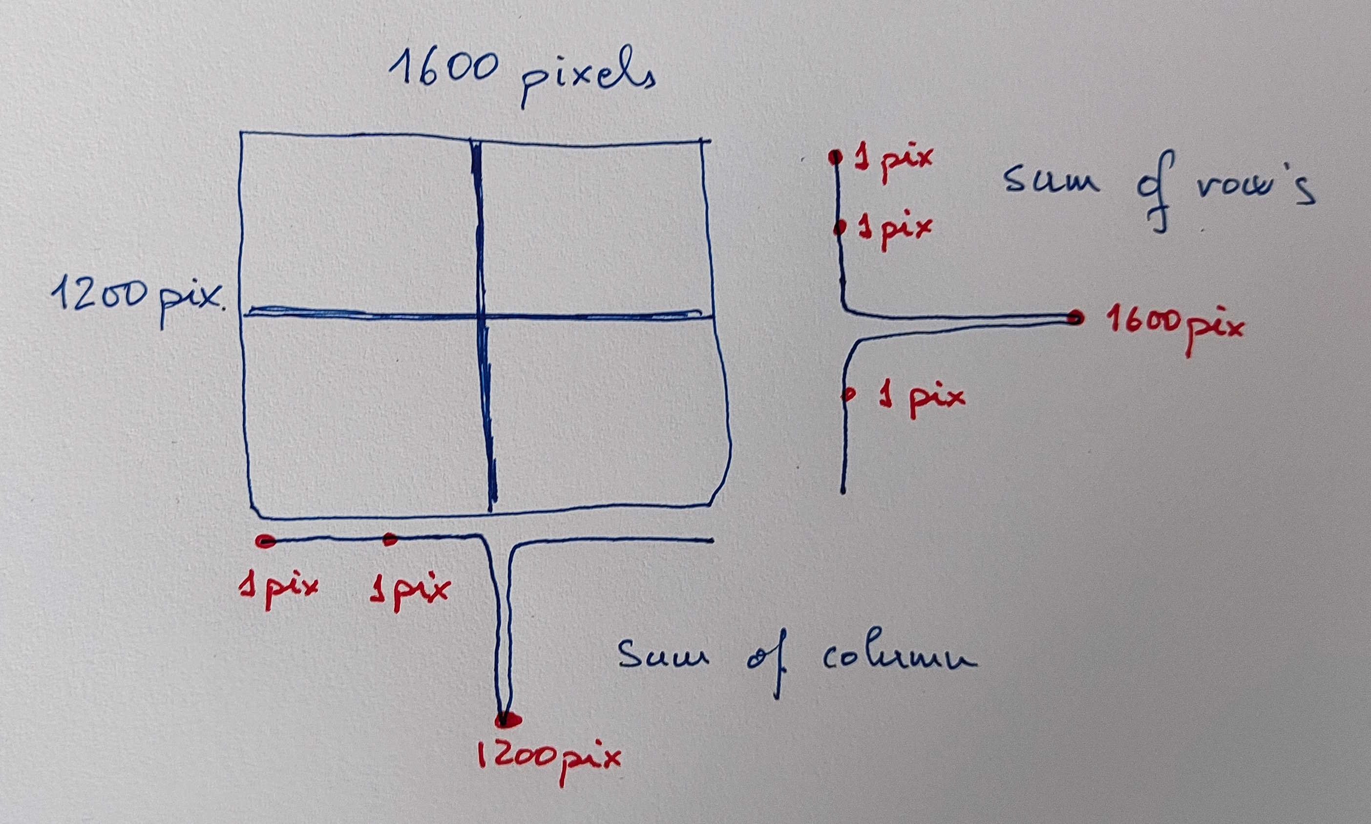

The image can be in color or black and white. To find the X, Y lines, you just have to add up the rows and columns of the image of the photo. The row and column that have the highest value (or lowest depending on how the photo was taken), will indicate the row and column of the cross.

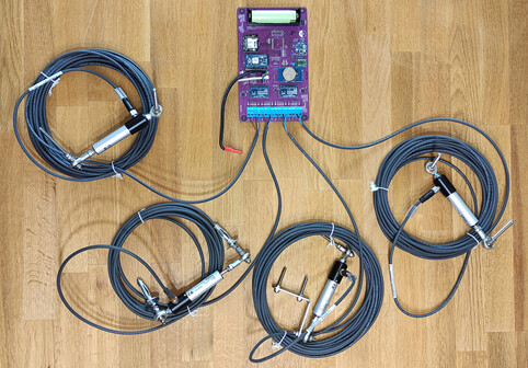

I am attaching a photo of the latest instrument we have installed at the Royal Monastery of Poblet. It has 4 sensors to monitor up to 4 cracks.

The digital processing of the image is very simple, since it simply involves adding the values ​​of the pixels of each row and each column. The row and column that provide the highest value are those that contain the lines of the cross.

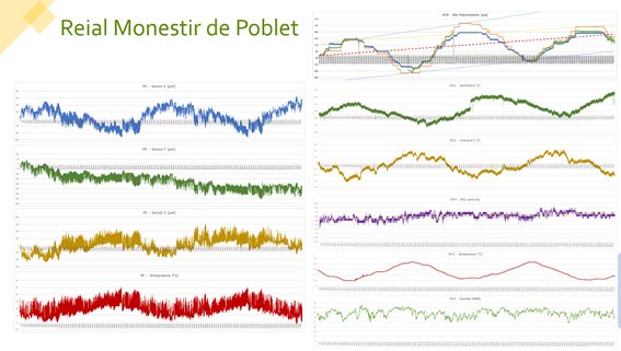

However, what we are interested in measuring is not the daily movement of the cracks, but the annual trend, which can show the danger of a collapse of the building.
In one of the monasteries we are monitoring, the upper part of the columns of the central nave (8m apart) has been separating 2.5mm every year.
This image corresponds to data taken over 2.5 years on one of the church columns (100000 samples). The upper curve on the right corresponds to the separation between the columns of aisle 4 of the church.
