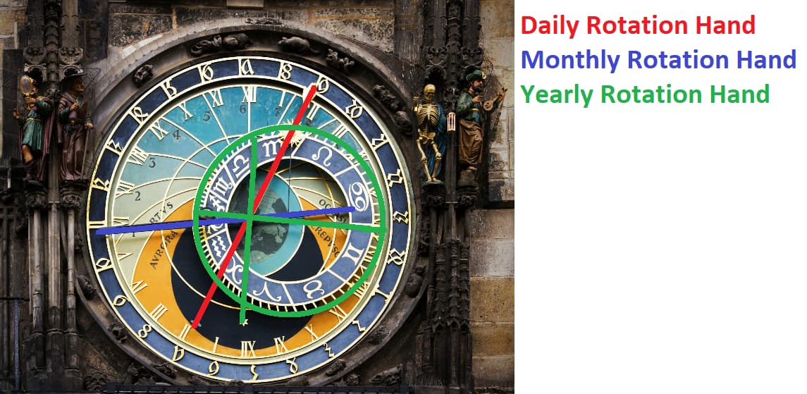

This mechanism would control 3 hands. 2 of them would be fairly light, but the third I don't think there's much a way around the weight.
I'm making a replica of the prague astronomical clock (for some reason, no one sells one that actually moves- they're all just normal clocks with this clock face.) I don't know if it's easy to make out- but there's three hands. Two of them are pretty normal, one has the little sun and the human hand on it, the other has the little moon. The 3rd is the big honker of the astronomical ring. It's actually a whole hand that ticks around.
Here I've color coded the hands so you can see. Even if I made it out of really lightweight board, that's a lot more stress than I think a normal clock hand can take.
Edit: This isn't actually how the real clock works either, the hand I've labeled "yearly" doesn't actually take a year to spin around, but instead is usually in step with the sun hand, but then once a day unlocks itself, goes a 1/365 step, and then continues to follow the sun hand.)
Nice project! You need to do some mechanical engineering, I would think, to offload some of the weight of that heavy hand from the movement. You could still balance it, though - it's usual to put the balance weight on the shaft, but behind the dial.
