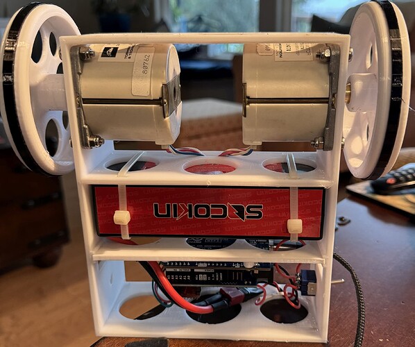

A proposal for a new robot balancing robot
This is the first draft of a proposal to create a 2-wheeled self-balancing robot library to show off some of the capabilities of the new Arduino UNO R4 WIFI.
My intention is to receive comments and critiques from people who are willing to contribute to this fun project. I currently have a prototype robot made with a 3D printer, and an iPhone that is running TouchOSC for controlling it. That enables me to be one of the beta testers of this library. There is more to add to this proposal, and I have started a skeleton library and example code for testing.
(As an aside, my robot is using stepper motors that are more than 60 years old and came from a printer that weighed more than me. Surprisingly, they work fine)
If this is something you are interested in supporting, please let me know how you can contribute. Could probably use a document reviewer, coders, beta testers. While I can do a lot of the coding, I am probably not the right guy for the more complex timer stuff, conversions and calculations, and accel/decell stuff.
I can provide the .stl files for anyone who wants to print one of these toys. I would just need a few details like the steppers you are using, the battery's dimensions, etc.
Here is the draft, please keep the comments, suggestions, and criticisms friendly.

Consider using a modern IMU. Both the MPU-6050 and the BNO055 were discontinued and have been obsolete for many years. Any of the modern replacements will significantly outperform either one.
Delta_G,
The size is determined primarily by the stepper motors and the battery used. Mine is quite large because the 50 rear old steppers are at least Nema 23 size if not bigger. Here are a few pics.
JRemington, Thanks for the advice, I'll check out some new IMU types.
Well, I did more than I thought I could on this, and my robot is nearly standing on it' own. I am using the FspTimer timers and though it's a little awkward to program them, they are working. I'm having a little trouble with one of the 50 year old steppers. If I can't clear it, I may need to switch to something more recent which means making a new body and wheels. I'll do that eventually anyway because these old ones and the huge battery weigh a ton. It will be tough for the servos to raise it when it falls over.
This is here for review. Positive comments, criticisms welcome.
I'll be out of town this weekend. When I get back on Monday, I'll probable make a new robot using standard NEMA 14 motors and work on this code some more.

Yes I do. I’ll put it the on Monday when I get home.
NEMA 17 will work great. I’ll make a design for 17s and 14s.
Sounds like a good idea to me. Also, if you have an android the TouchOSC works with that and it works with a PC too.
Would be cool if it could work with a PS4 controller too but that would definitely be a future item.
Anyway, gotta get it to stand up first. Gotta crawl before you can run.
Something I thought of last night is servo control. All it needs is a timer and very little code. That would obviate the need for using another library.
I’m going to add the Sparkfun 9DOF IMU. It has the QWIIC connector that will plug right into the R4.
As I understand it, there are 2 AGT timers. One is used for both millis() and micros(). I agree with using AGT for the servos, but not the one serving those two functions. I want to preserve millis and micros if we can.
In another post you made it clear that you would rather use your own timer rather than FSB.
Are you working on one or do you already have one?
At a minimum, the robot will require throttle and steering inputs from the remote control. Later we could add kp, ki, kd adjustments and others. You mentioned exposing API's, but I'm not sure how those work.
I put the current code in github at github/PickyBiker. It's private so just let me know what your github name is and I'll give you access. I have never worked on a project with someone before, so I need to learn how to actually use github for that purpose.
The .stl files for a NEMA 17 size robot are posted in github. The tire was printed with TPU and the rest was PETG although any material would probably be okay.
I'm working accel/decel without using the acceleration library. This will finish the motor driver code. and make us ready for communication, OSC and API.
Looks like baby is crawling now. Really nice to see someone make what I built do what it was designed for. This is real progress.
