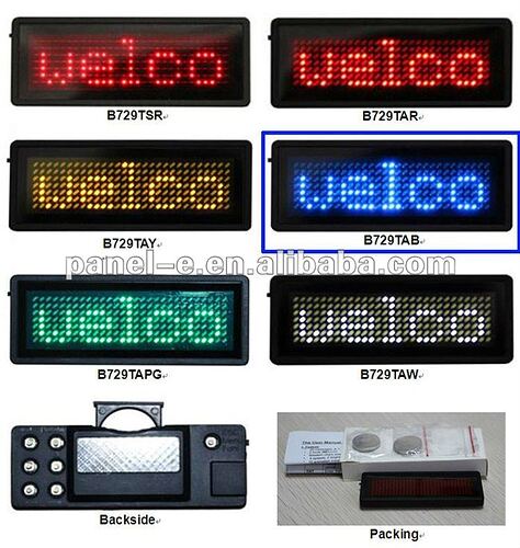

I got $10 "name badge" which I can connect to the computer using a USB cable and Prolific USB-serial adapter, and, using the provided software, I can have it display 120 chars scrolling message.
I used a serial monitor and figured out the protocol it is using to upload the text. Also wrote a short tool to send my own text. Now, I would like to have the Arduino send text to it using software serial.
So my question is: When I connect the Prolific adapter, I get a serial port on my PC. The cable from the adapter is a to the LED display is a USB cable. Can I assume that the D+ and D- pins in the USB cable are the serial Tx and Rx? Can I just take those two pins and connect them to my Arduino's digital pins and use the software serial library?

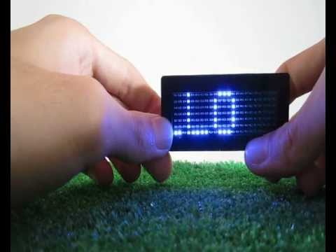

You can see it in action here:
Some pictures:
