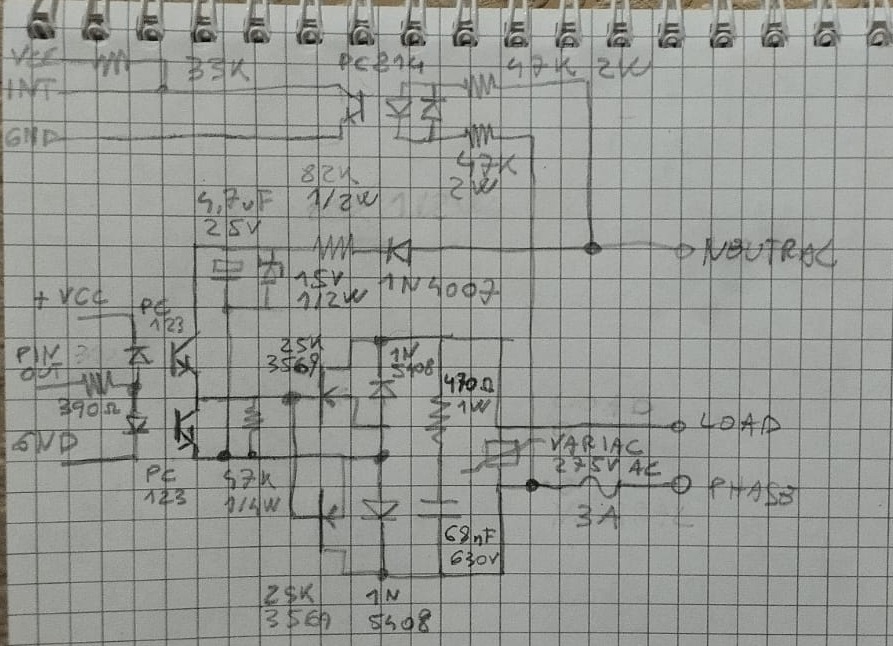

I need trailing, which is the only fully compatible way with LED bulbs, 220V, dimmable.
This circuit doesn't use triacs, it uses 2 mosfets, to manage positive and negative half waves, and it needs an enable signal for all the necessary period, not only a signle pulse that works with triacs.
The library Juraj posted seems ideal, it gets the interrupt of zero crossing which load up the timer as counter, which is connected to the hardware pin, so the CPU is free to do what it wants, and the process is mostly hardware managed. Yes I need 2 dimmers, it needs 2 timers of Mega 2560, they are available so all is ok.
I have to look inside the library, cause it's designed for triac, it works opposite than I need and I need to avoid only pulses. I hope the author is interested to make it compatible with trailing edge, soon I'll post the scheme

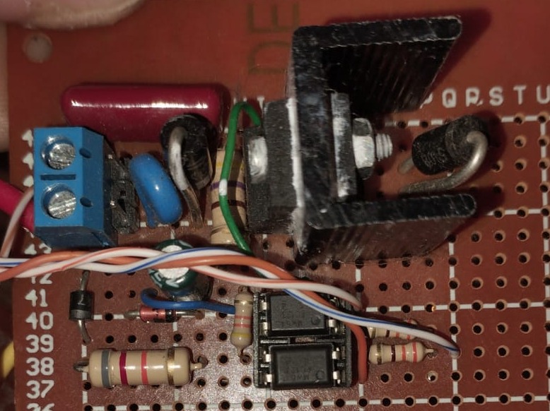

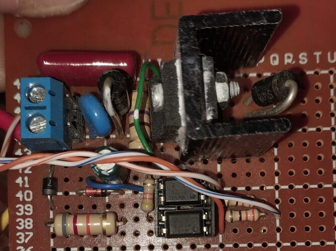

This is the circuit I've designed for 220V (for 110 you need to recalculate), it's efficent, works with low temperatures and consuming 0,147W on st-by, mosfets have only 0,57ohm resistance and support up to 10A (but I recoment use till 3A, in this case you can use a small heat dissipator and you can put the 2 mosfets on the same radiator, containing spaces), am extra diode is used to reduce the forward voltage of the internal mosfet's diode, lowering mosfet's dissipation and working temperature, they can be eventually avoided.
The circuit is driven by 2 optocouplers, one is used to activate mosfets, the second to discharge the gates quickly, leaving mosfets operate on saturation only.
The microcontroller used should be loaded enough to assure optocouples create the most available saturation of transistors, to fast charge/discharge gates. For 5V microcontroller a resistor of 390 ohm assures about 13mA for light the opto's leds, on low and high; for 3,3v controllers use 220/270 ohm. The circuits activates the load with LOW logic and turn mosfets off with HIGH level, this is preferable according the fact microcontrollers boot usually with pins on input mode and high pullup internal resistor. Only a forced LOW level can turn on mosfets.
Snubber is optional, by the way it's better to use anycase to preserve life.
I've added the zero crossing detector, I have to work on it more, probably I'll insert a capacitor to avoid noise, maybe it's not necessary an EMI filter. I've to focus to optimal values for resistors to reduce dissipation without enlarging too much the zero crossing LOW time detect.
The zero crossing takes about 0,5W dissipation, I guess it's possible to combine it with the power needed to turn mosfets but the result won't change too much
Hello, I am very interested in the 220v zero-crossing detection circuit diagram you shared. But I can't see your picture very clearly. I hope to get a clearer picture. Because I am also designing this zero-crossing detection circuit, I sincerely hope you can help me. Also, I want to know what is the maximum temperature of the resistor on this circuit, this is very important to me.
