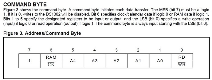

I wanted to try to bit bang a write command to the DS1302 so I looked at the data sheet http://datasheets.maximintegrated.com/en/ds/DS1302.pdf , but I don't understand bits 1 - 5 (A0 - A5) of the command byte, how can you choose a register address with just 5 bits? For example is I want to write to the Year register I have to choose 0x8C, but how can I represent 0x8C with just 5 bits, am I missing something here?

Yesterday I was able to write data to the YEAR register but when reading it back it did not come out correctly all the time. If the binary value written ended with a 1 the read value would come out correct, but if I would write a binary value ending with a 0, then when I was reading it back the code (arduino shiftIn) would discard the last zero, so e.g. decimal 14 is 0000 1110, but the read operation would send back only 111.
Perhaps it has something to do with the fact that DS1302 codes values in BCD and I'm missing something, or maybe my DS1302 module is faulty, I might have to get another one to make a comparison.
