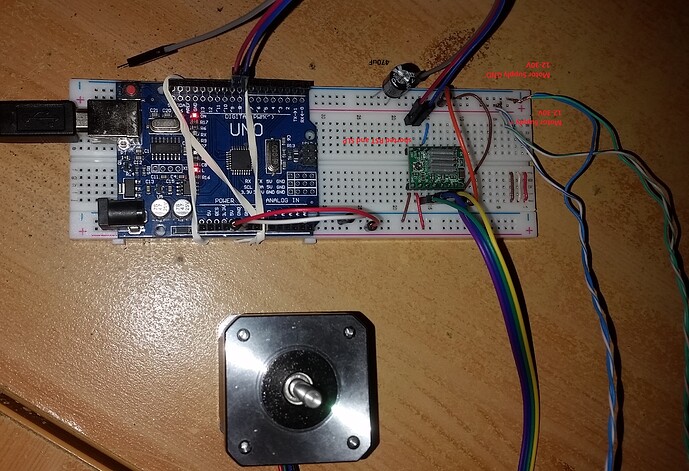

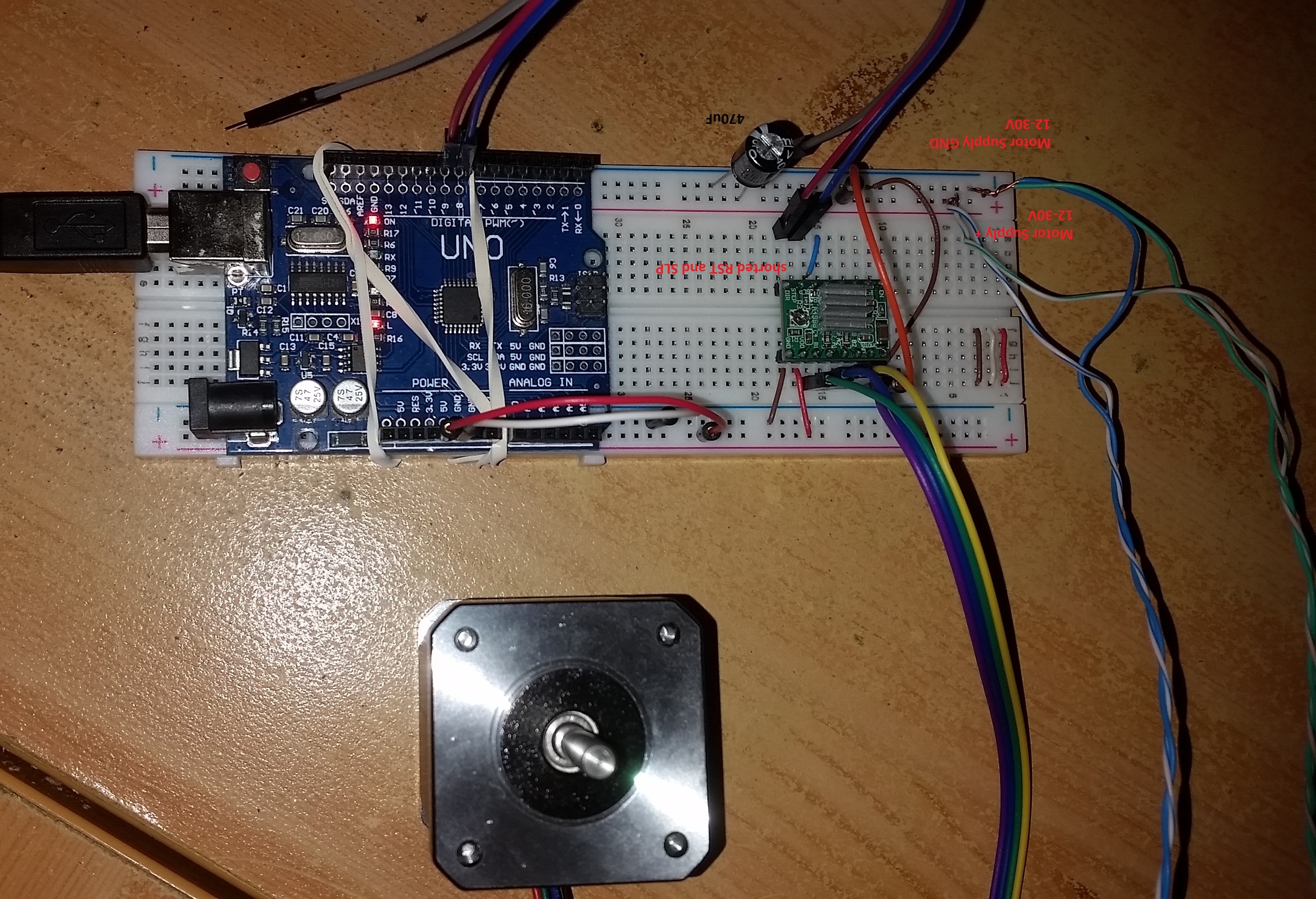

I´ve attached a photo of my setup.

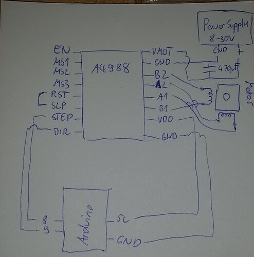

The programs have worked for others so I guess you have a connection problem or an inadequate power supply or a faulty A4988. The stepper drivers are easy to destroy if a wire between the driver and the motor becomes disconnected while the driver is powered.
Photos of hardware are not reliable guides for wiring connections. Make a simple pencil drawing showing how everything is connected and post a photo of the drawing.

I dont suspect a faulty A4988, I bought 5 at a time an none is working. Seems unlikely they are all broken.

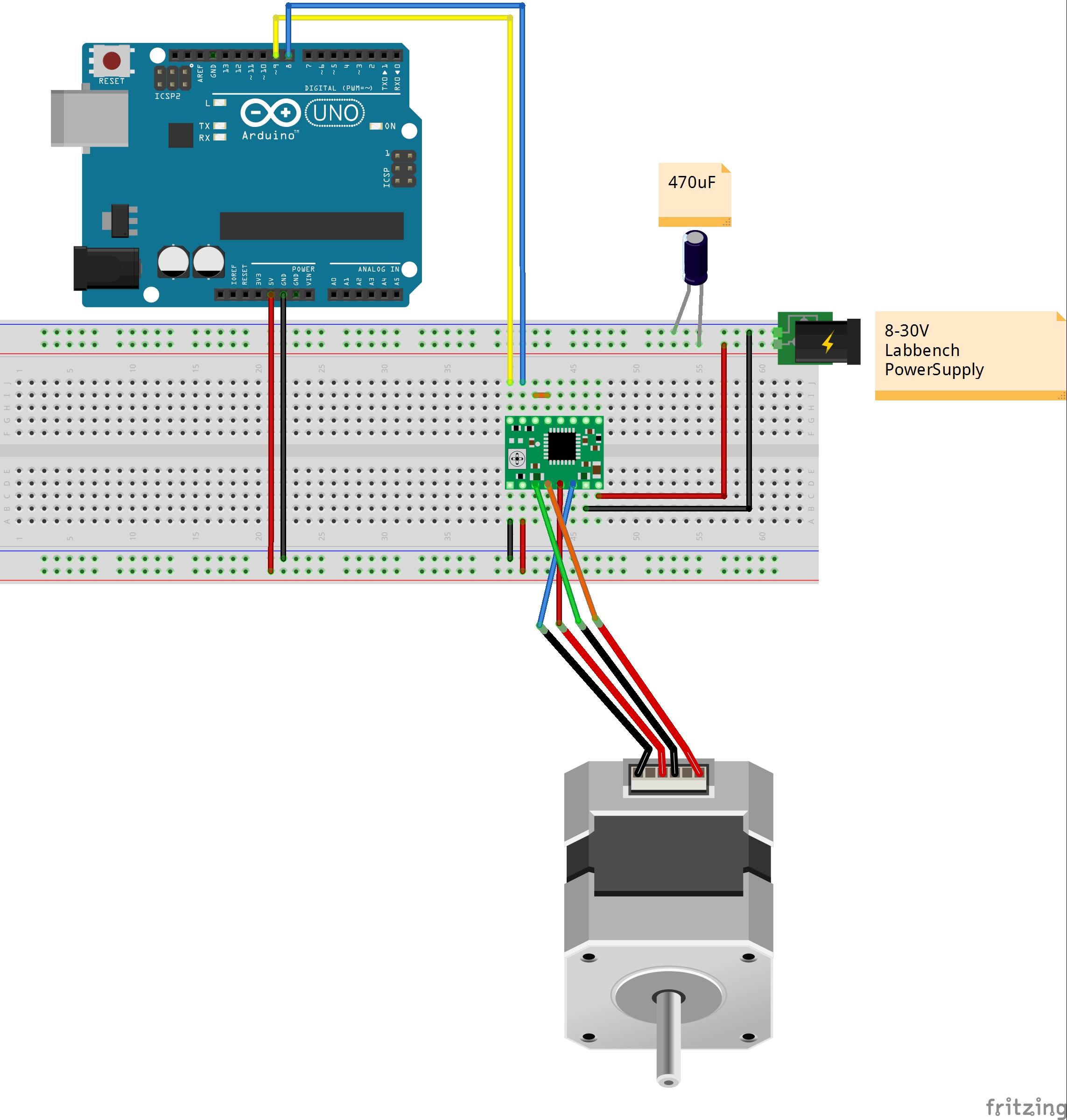

Here´s a schematic I quickly drew up with fritzing.
kRz_4tw:
I deliberately suggested a pencil drawing because, as in this case, a Fritzing diagram is usually not at all clear.

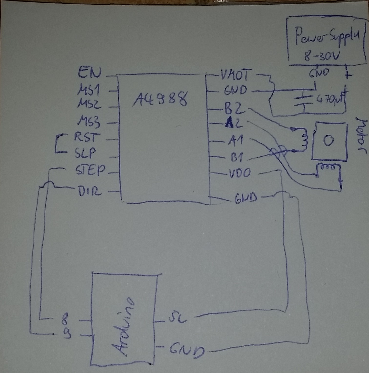

Here you go
Jesus, I got it. The documentation I was reading stated to connect one coil of the stepper to B1 and B2 and one to A1 and A1. Also on my ebay A4988 the pinout declation is swapped form 1A 1B... on the pololu units to B1, B2,... on my unit.
Running fine now after the coils are connected A1,B1 and A2,B2.
Thanks
On the Pololu A4988 web page the A4988 pins are labeled 1A and 1B for coil1 and 2A and 2B for coil2
...R
