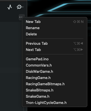

Ability to hide/remove without deleting newly created files
Now before anyone gets mad, let me preface this by saying, "Yes, I did a quick search and didn't find my answer even though I can't possibly be the only one who is asking this..."
I am using Arduino IDE Ver. 2.3.2 on my M1 Mac Mini (not sure that is relevant but I rather not leave anything out)
I have created a bunch of files, mostly games but I also have some bitmap files that I don't really want to see clutter up my file bar at the top.
Is there any way other than copying the current sketch folder, deleting it and pasting the original content back in to "hide" the files I don't want to see?
It would be a nice feature to have a "hide" button here in this menu, maybe just a little eye icon that could be toggled like if I wanted to hide a layer in photoshop.

Or how about a way to group files together into subgroups ?

If you want to re-use those bitmaps in other projects, I would create a directory called e.g. bitmaps in the libraries directory and place the bitmap files in there.
If those bitmaps are specific for the project, you can create a directory called src in your sketch directory and in there create a directory called e.g. bitmaps and place the bitmap files in the bitmaps directory.
Not tested but both approaches should work.
Yea, I guess that works. It did remove all the files I didn't want but its not exactly what I wanted. I'll take what I can get though.

I think that putting the files under the src subfolder is the right solution.
The files will not be shown as editor tabs in Arduino IDE by default, but you can open and edit them on demand in Arduino IDE 2.x by doing this:
