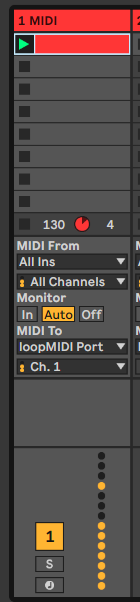

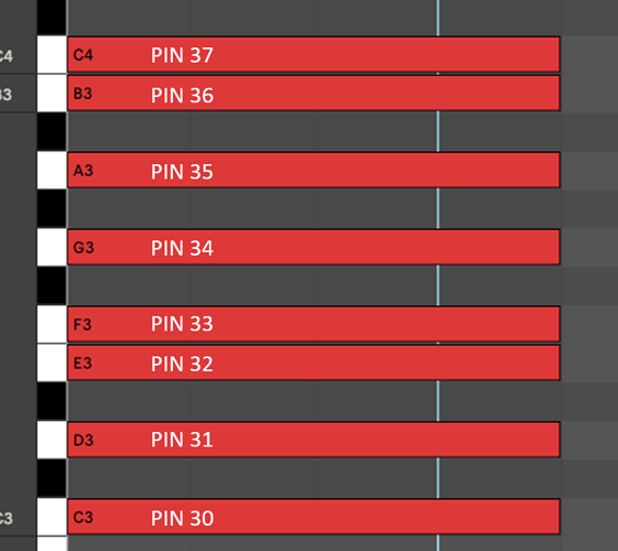

I am pretty new to Arduino and I am trying to work on a project that uses MIDI from Ableton. The end goal is to have it so that Track #1 on Ableton sends MIDI notes (C3-C4 white keys only) and these notes translate into a true/false statement output. For example, note C3 would be pin #30 on the Arduino Mega. When C3 is played in Ableton, pin #30 turns on, else the pin is inactive.
I am currently using Hairless MIDI and loopMIDI, which seem to recognize there is a MIDI output from Ableton, but I can not figure out how to turn these values into a true-false statement for Arduino outputs. I have looked through many tutorials, but all I can find is DIY MIDI controllers, where an analog button pressed on an Arduino plays a note in Ableton. I have included pictures of how my computer is set up, as well as a .txt file with the code I have currently. Any help or tutorials would be very much appreciated.
When the Arduino receives the midi message it tests the note number for an expected value and sets a logic variable accordingly. So note on sets the logic variable high and a note off sets the variable to low.
You do not get Ableton to do this because it has no idea about pins, it only knows about midi messages.
I don’t see you sending anything from Ableton, you should use an external instrument directed to hairless to do that.
