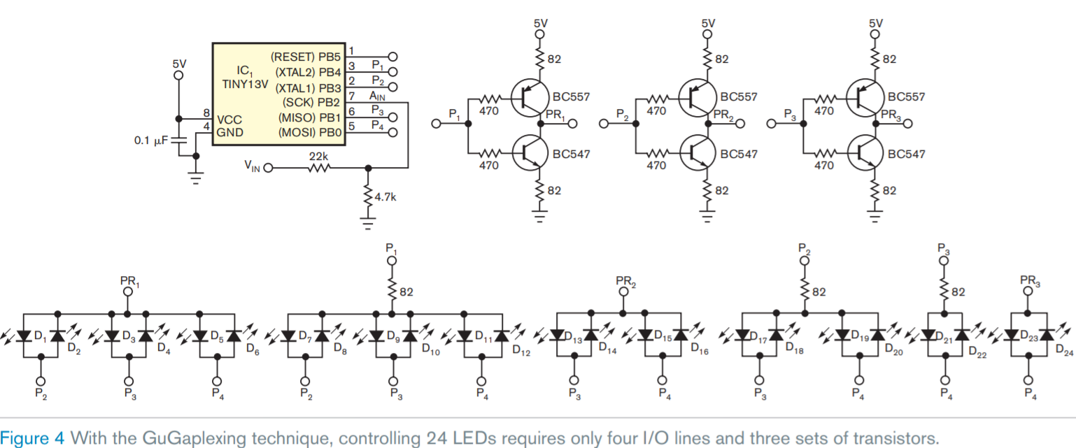

I want to expend the used method for to can handle many more leds with 3 or 4 wires for example
=> It is possible and is the good formula numLeds = (numPins) * (numPins+1), cf. (3) * (3+1) = 12 leds with 3 wires and (4) * (4+1) = 20 leds with 4 wires ???
(note that this is perhaps numLeds = 3 * numPins or 2 * (numPins +1), no idea about the real formula ... if the fomula exist :smiley: :smiley: )

==> what I want is something like the gugaplexing scheme with 3 I/O pins but I don't find a scheme of it using 3 I/O pins (founded for 2 I/O pins and 4 I/O pins but not for 3 I/O pins)
(of course extended if possible using the "Jnenabadji-plexing" :smiley: :smiley: )
[something like handling at least 12 leds, or more if possible, with only 3 I/O pins]

This need of course a lot of transistors/resistors, something like 2 or 3 pairs of BC547/BC557 and the same proportion of 100/150 ohms and 10K resistors but I think that this can be handled for 3 I/O pins
(this is perhaps too complex for > 4 i/o pins but can perhaps to be handled for 3 i/o lines, no ?)
Think something like this scheme but that only handle the 12 leds on the right and quite certainly only two pairs of BC447/BC557 instead 3
https://content.instructables.com/ORIG/F39/ULD1/JNULIHHX/F39ULD1JNULIHHX.png?auto=webp&frame=1&width=1024&fit=bounds&md=fcc4e7bae65a9b7ff6e17f663170408d

Consider:
PCF8575
No idea what your price will be, of course.
C
what is your final goal?
Basically if you use a LED driver instead of a port expander and wire your LEDs in a Matrix than it it should be easy to find an alternative:
I2C: HT16K33 ---> one IC for 128 LEDs in a matrix, up to 8 ICs on the bus
(nearly) SPI: MAX7219 --> one IC for 64 LEDs in a matrix (and only one resistor for all LEDs), possible to daisy chain these ICs
and instead of a pure port expander, see the this alternative:
I2C: SX1509 --> one IC for 16 LEDs on discrete pins, but also PWM, pulsing LEDs, keyboard matrix ...
