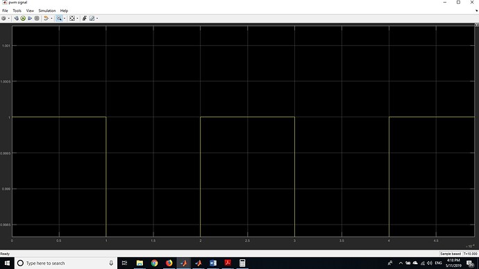

HI
I am using matlab simulink to apply MPPT techniques. I produce a pwm signal with 5000 hz. when i send this signal to a pwm pin of arduino, i measure it with oscilloscope and it shows nothing. i found that i should increase the amplitude of the pwm signal in matlab to 1024 to get 5 volt amplitude in oscilloscope. the problem when i multiply the pwm signal in a gain of 1024 the duty cycle and the frequency changes !
Is this anything to do with Arduino, or entirely something to do with MATLAB?
i will send a pwm signal from simulink to arduino which switches a buck converter circuit feeding a dc pump
at the photo attached this is the correct pwm signal.. i want to amplify this signal to 1024 to get 5 v output in arduino pwm pin. multiplying with a gain in matlab changes the wave duty cycle and frequency ! any solution
Why not use the Arduino to produce the PWM signal?
To get 5 kHz output you will need to specifically program one of the timers. Timer tutorial here.
I should use simulink to produce the PWM signal as i make a project which i use a pv module with voltage and current sensors to determine the duty cycle which is then converter to pwm signal sent to arduino. this signal is changing with time as the voltage and current of pv module change.
Is this for a class?
If not, the Arduino can do all that.
yes a master thesis unfortunately
