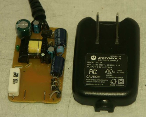

Wall warts are safer and probably cheaper. Mass produced, you know. And frequently small enough to fit inside a project box. Depending on how many you need, you may be able to extract the guts of a cellphone or USB-style wart. Frequently they see, to be nicely modular:

westfw, I'm using a very similar Motorola USB charger's guts in my current timer project, with added screw terminals, and I'll zip-tie it to a piece of acrylic and mount in the case with standoffs.
