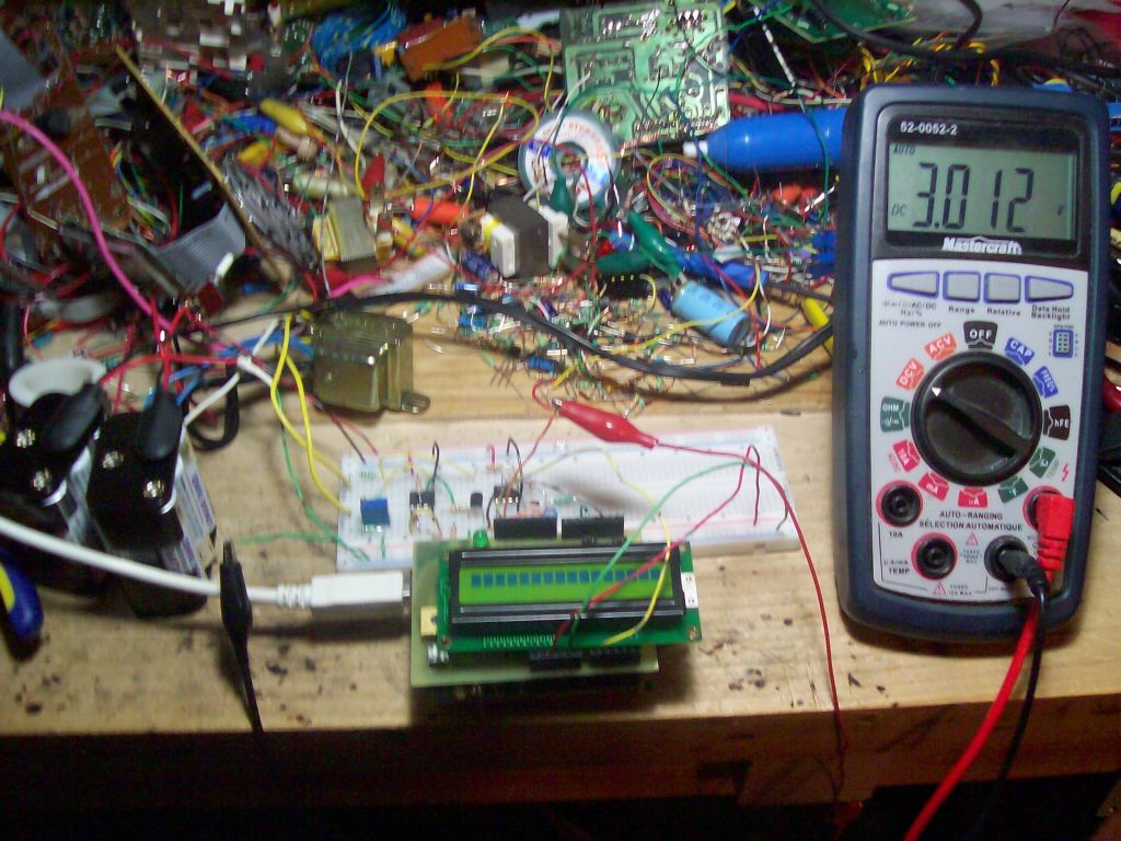

Hi guys;

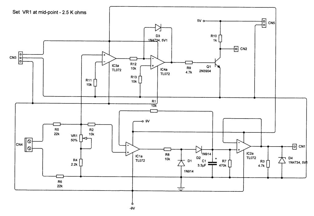

I did a project about monitering the AC main and the frequency. I constructed the circuit to take AC voltage measurment convert into a proper DC voltage the analog pin can received and take the frequency into a square wave into a digital pin.
To take AC main, I use a transformer. The transformer I use have : 2 secondary output, one is a CT type <- center tap. I will use the center tap secondary to be use as a power supply to provide a dual-power rail line, and the other secondary, for the AC voltage sample to be measure.
For calibration, use a 5 K multiturn pot for VR1 to get at the output for a 3 V out. Measured the Main with DVM - AC mode to have the main voltage. Take the V main / V out = Main Ratio in your code. Also measure the Aref of the Arduino and place in the code like : Aref / 1023.0 <-- that code line. I will use a precision V reference <-- Kind of voltage regulator to have an exact V ref so I can use in the code.
Right now, it is only a prototype code - without LCD, which I will use later. To test my code, I use the serial monitor to see what values I have.

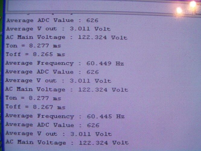

Here is the code and a picture of my results of the serial monitor.

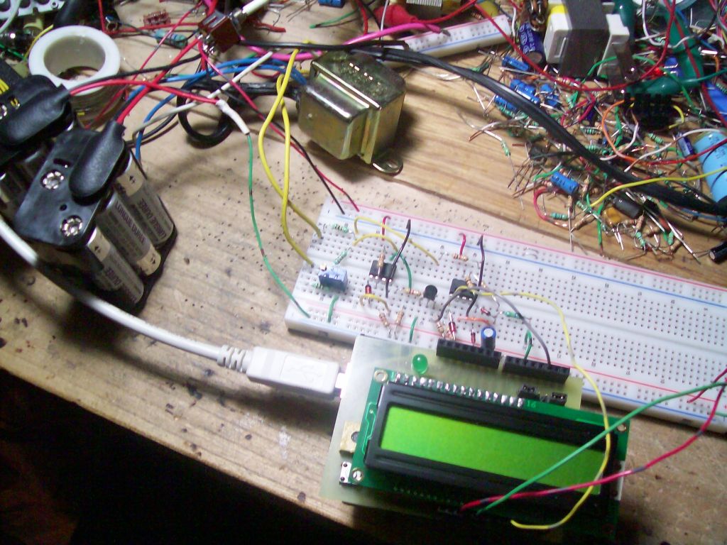

Here two pictures of my setup.
Top : The set-up
Bottom : Live set-up.
A long time ago I read of a similar experiment where the user recorded the AC frequency over the course of a day to see how it changes; in the past there was always some effort by manipulators of the grid to slow it down or speed it up to keep it accurate to 60Hz so that clocks that depend on that frequency would be correct.
It would be surprising to see it continually at 60.5Hz as it shows in your readout; that's quite a bit of error. But I'm sure that's the grid's fault and not any mistake of yours :wink:
I agree. It is a good idea to monitor during the day, I am planning for it. I will modify the code to send to the serial port, in addition to display the voltage and frequency to a LCD display. I will place a switch call : To data logger - No data logger. I will also build an another project, it will simply take data from serial and store it into a SD card. Just a data logging project. To log any type of data. And at the computer side, a program to analyse the data store inside the SD card. That what I plan to do.
I know, it will be interesting to see that data and to see the power generating to the city of Toronto - Ontario Hydro / Toronto / Hydro is stable or not. It will more interesting to see the voltage and frequency during the summer. Most power failures happen during the summer.

Out of random curiosity -
Is the transformer for this 9v with the center tap at 4.5v? Or is it 18v with the CT at 9v? Or is it 36v with the CT at 18v? It looks like the main voltage gets applied to CN4, and is AC, while the CT voltage would be applied to CN3, and be DC, correct?
Also, are my assumptions here correct about the connectors on the schematic?
CN1 = voltage measurement to arduino board
CN2 = frequency measurement to arduino board
CN3 = 9V in (top pin is +9v, center is ground, bottom is -9v)
CN4 = AC in (9v?)
Thanks much!

There is also a CN5 (+5v for frequency measurement).
Here's his two inputs:
byte inpulse=2; // square wave input digital  pin
byte voltpin=1; // Vout input anaalog pin
I think a V/F converter with step-down resistors would be simpler but I guess this works.
