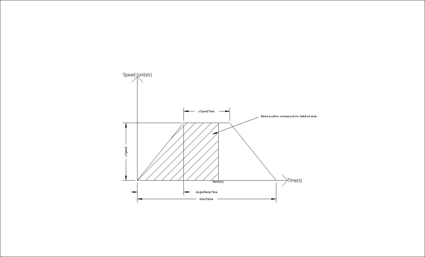

So, do i understand you correctly as this is what you want to achieve?
  • You want to take pictures that have the same shoot positions as if you where shooting at a constant frame rate during a acceleration/constant speed/deaccelleration (trapetzoid profile) movement
  • You want to stop the slider at each shoot position

I believe this is what you want to do, but not quite sure:

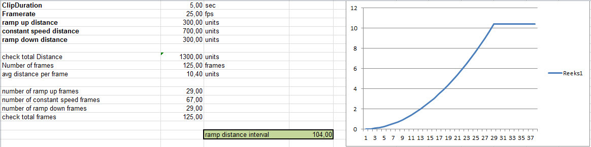

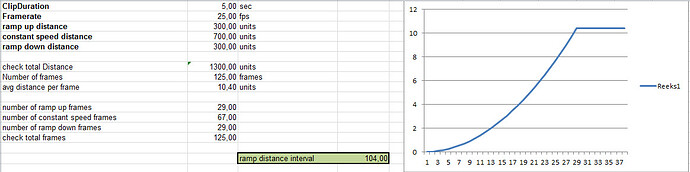

Could have a quick look at your excel en played a bit with it
  • looks like you are still involving the time element in this..
    time between frames is only relevant for the speed of the video and completely irrelevant for the camera movement where this is all about!
  • I put all frames in a row and I'm afraid it's not giving the result you tried to achieve..
I added a new TAB to the sheet which shows better what I want and where we differ and that's how I implemented it arduino at this moment.
It looks like nice this way but as you can see the total ramp up distance is short. 104 for optimal ramp curve and 300 for required distance.
(See updated excel and graph)
The extra TAB in the xls (fred-experimental) shows the frame numbers (55 ramp and 41 constant frames, instead of 26 and 67) which has the correct result IMHO. But this is just achieved by experimental changing values and not using math...
