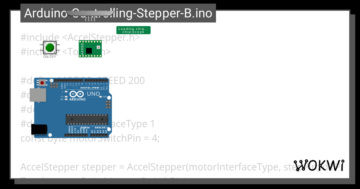

I think just using negative speed, something like:
```arduino
stepper.setSpeed(-motorSpeed);
> [@peterbuilt](#):
> I have used the accelstepper library
The -'ve sign works here with the the accelstepper library ...
> **[Arduino-Controlling-Stepper-B.ino - Wokwi ESP32, STM32, Arduino Simulator](https://wokwi.com/projects/360447750612611073)**
> Run IoT and embedded projects in your browser: ESP32, STM32, Arduino, Pi Pico, and more. No installation required!
