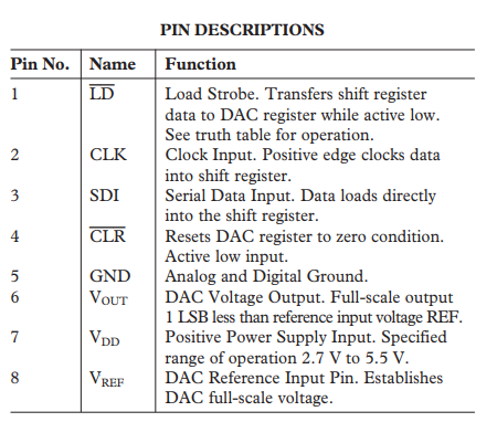

New to Arduino, trying to get AD7390 DAC to work with Nano Matter using AD7390 Library. I assume that IC and library are using a modified SPI interface.
Nano connected to laptop by USB. IC powered by 5V port on Nano.
Following information in the data sheet and a Forum post as best I can.
LDbar(IC 1) to D8 as suggested by codes in library examples (CS = pin 8)
CLK(IC 2) to D13
SDI(IC 3) to D11 (MOSI)
CLRbar(IC 4) to VDD (5v on Nano)
GND(IC 5) to Gnd on Nano and digital scope
Vout(IC 6) to digital scope
Vdd(IC7) to 5v on Nano
Vref(IC 8) not connected

Found the datasheet, not a complex device.
So you need to connect Vref to Vdd == 5V
(or e.g. 3.3V or make it configurable with a potmeter
That sounds to me like you are missing a ground connection between your oscilloscope and the Arduino ground. In other words something is floating. As there are no negative voltages involved you should not see one on an output.
Sorry I do not follow word salad as you have substituted for a clear annotated schematic. That schematic needs to show exactly how you have wired it, all power sources, ground connections etc. Links to technical information on the hardware items also helps.
I downloaded the library through Arduino IDE: GitHub - christophjurczyk/AD7390_Arduino_Library: Arduino Library for the AD7390 DAC
I have the spec sheet, will study it further.
Connecting Vref to Gnd, 3.3v or 5v (=VDD) on the Nano makes no difference.
Nano, 7390 and scope share grounds, scope ground definitely connected.
