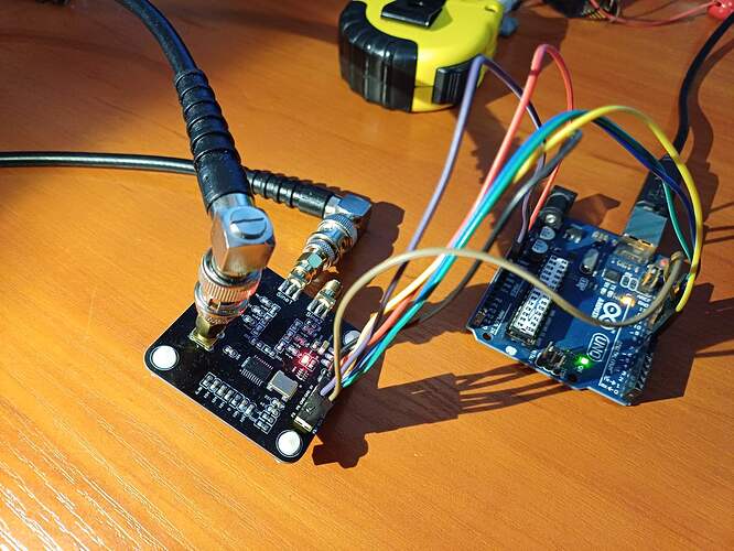

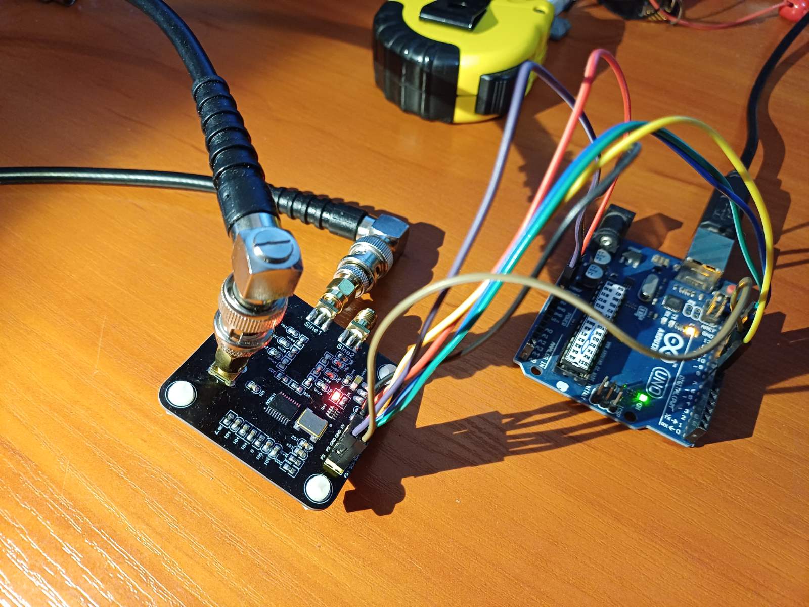

Hello all. I am at the initial stages of trying to use an AD9834 module (china) with arduino.
So far, I have managed to write to the control register, frequency and phase register and get a decent sinusoidal output.
This module is also able to output triangle and square waves. But I have not been able to achieve either output yet.
1. Triangle Wave:
IAW the datasheet pg. 22, Table 18, I should get a triangle output when in the control register I have both:
  • The OPBITEN bit CLEARED.
  • The MODE bit SET.

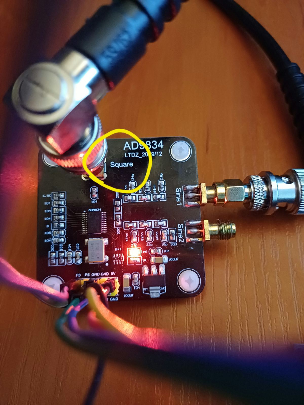

2. Square Wave:
  • IAW the datasheet pg. 16, reads: "detector, it requires a minimum input frequency of typically 3 MHz."
  • IAW the datasheet pg. 22, Table 17, to output a square wave I need to have the bits set as either in line 2 or 3 or 5. I would expect a square wave pop-up from the SMA name "square".. Correct?

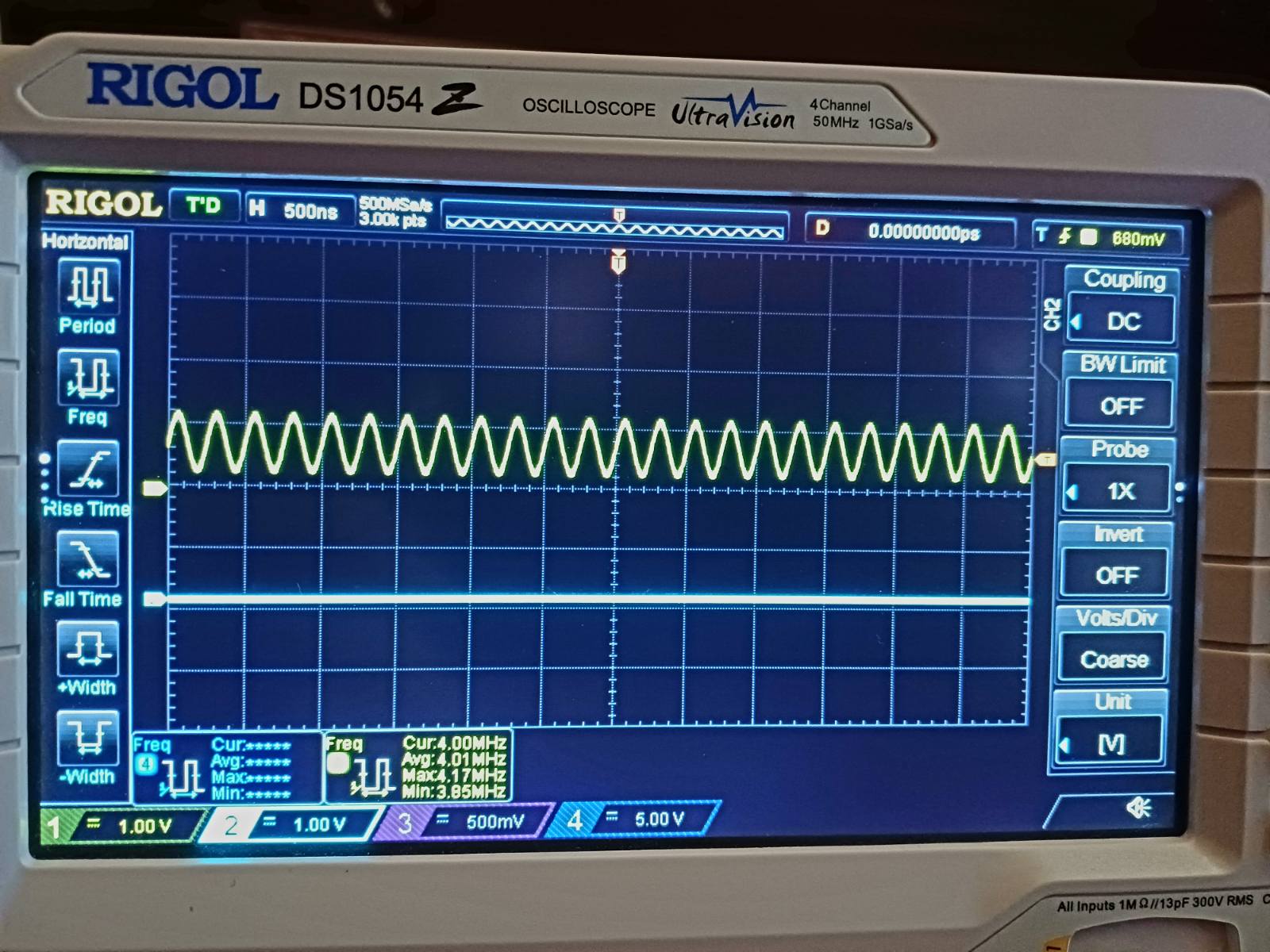

I have done all that, but I only get sinusoid from the 2 SMAs that are for sin and tri and I get nothing from the SMA that is named "square"..
Am i missing any elephants? Ideas?
