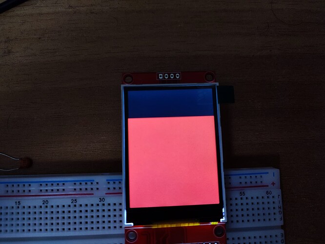

Hello, I have a problem using my 2.4" tft ili9341 display. I am using the Adafruit_ILI9341 and Adafruit_GFX libraries. I am trying to fill the screen with a color (using the fillScreen() function) and a part of the display remains as is. When I rotate the display and use the same function is fills the previously unchangeable part but leaves another part behind. Also text behaves the same way (as if that line was the end of the display). Thanks for your time.

Hi, could you also post a picture of what happens when you rotate, that may (or may not :innocent:) help ...
In any case, did you print out the following data, possibly with rotation set to 0 and to 1? Just to see if the driver has got the correct data for width and height ...

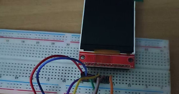

This is a video of what happens. Unfortunately I can't show you what happens when it rotates because I accidently shorted the nano that I was using and blew the usb diode. I will post another video when I get a replacement.
I don't really know what you are looking for...:thinking:

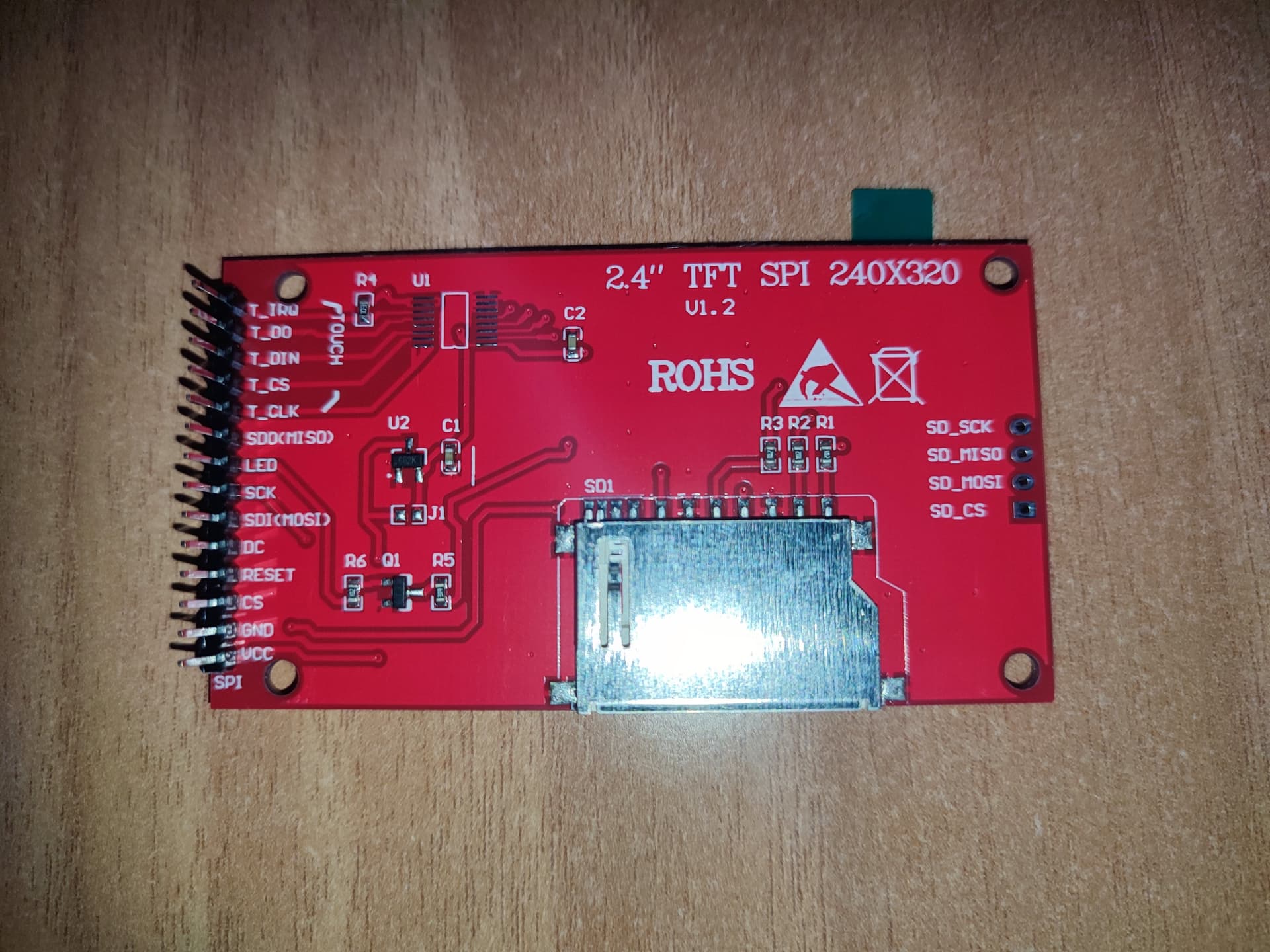

Thanks for the photo.
R4 is resistor
U1 is (unmounted) XPT2046 Touch Controller
U2 is 3.3V voltage regulator
Q1 is transistor (for switching the backlight on)
C1 is a 100nF capacitor
SD1 is the SD socket.
You can generally read part numbers that are printed on transistors and integrated circuits. Or resistor codes printed on resistors. Capacitors you identify by sight.
There is no level shifting circuitry. Which means that you have to provide 3.3V logic signals.
The Ilitek ILI9341 will not work with 5V logic. I am surprised that you saw any pixels at all !
Most TFT controllers are not 5V tolerant according to their datasheets.
Which is why respectable manufacturers like Adafruit provide 3.3V level shifters on their displays.
If you believe in Jewish Space Lasers you can put your trust into Ebay shops.
Incidentally, there are Red SPI displays with HC245A level shifter chips. But your photo has no 74HC245A chips.

It is very simple to just put a few resistor dividers on your breadboard. Ensure that you have 3.3V logic signals. All of the Adafruit_ILI9341 example programs should work 100%.
I am a little surprised to see RED pixels being plotted from the bottom upwards. Especially when the screen is in PORTRAIT rotation and BLUE pixels were specified.
And of course, I was mostly surprised to see anything at all !!
So when you have 3.3V logic, please copy-paste the result from reading the "ILI9341" registers. Especially the ID. Perhaps you have a different controller.
