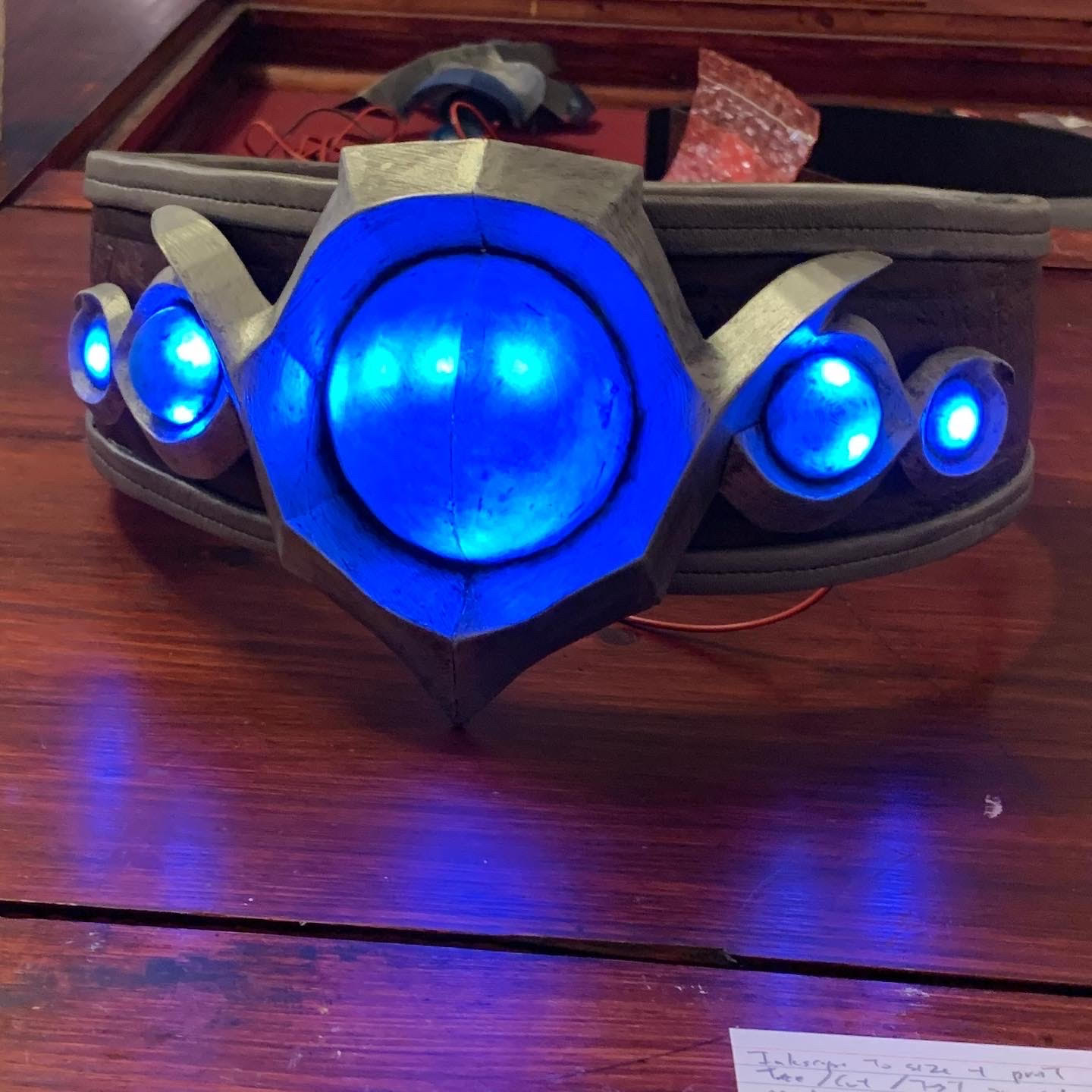

I am including a picture here of my previous ItsyBitsy project, because it's cool.
