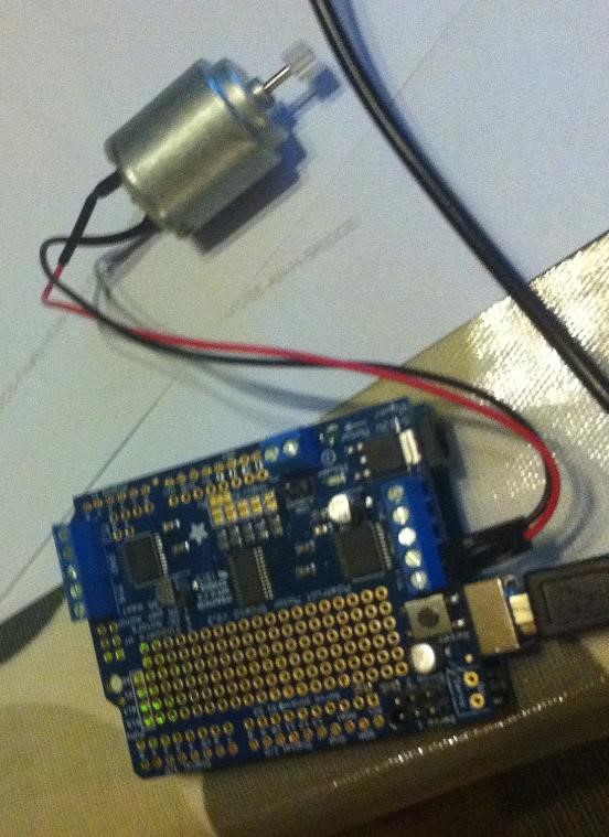

When I use the adafruit motor shield for the DC motor party, the programme uploads, but the shield fails to work, and its power light doesn't turn on, and the motor doesn't work. What is the problem in this case?

this is a picture of it. It took a bit of time to compress, but here it is now.

This is what the sketch looks like and it's supposed to work, but the light on the shield doesn't switch on

Does the shield need a separate supply for the motors, this is usually the case.

I posted the sketch and the jpeg picture of how it was plugged in and powered.
If you read the schematic, you will find the Green LED is powered by the motor powersupply which is connected to the terminal pair marked MOTOR POWER.
The motors do not run of the arduino supply, it cannot supply enough current.
Tom.... :slight_smile:
TomGeorge:
It looks like the shield can take power from the Arduino's Vin line.
It's hard to tell in the photo but I think the jumper needed to power the motor from the Arduino is in place. If an appropriate supply is connected to the Arduino's barrel jack, it should be able to power the motor.
The shield (wisely) doesn't include an option to power motors from the USB connection.
