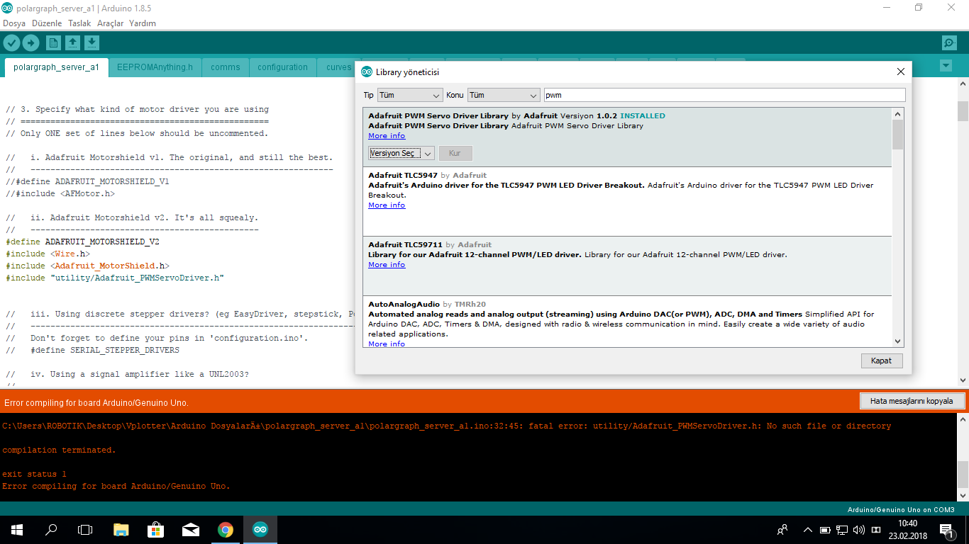

I Was Trying Make A XY plotter but when i try the upload (or debug) i got this Error On Ubuntu 16.04 LTS
Here's The My Error
/home/%FOLDERS%/Vplotter/polargraph_server_a1/polargraph_server_a1.ino:64:45: fatal error: utility/Adafruit_PWMServoDriver.h: No such file or directory
#include "utility/Adafruit_PWMServoDriver.h"
compilation terminated.
exit status 1
Error compiling for board Arduino/Genuino Uno.

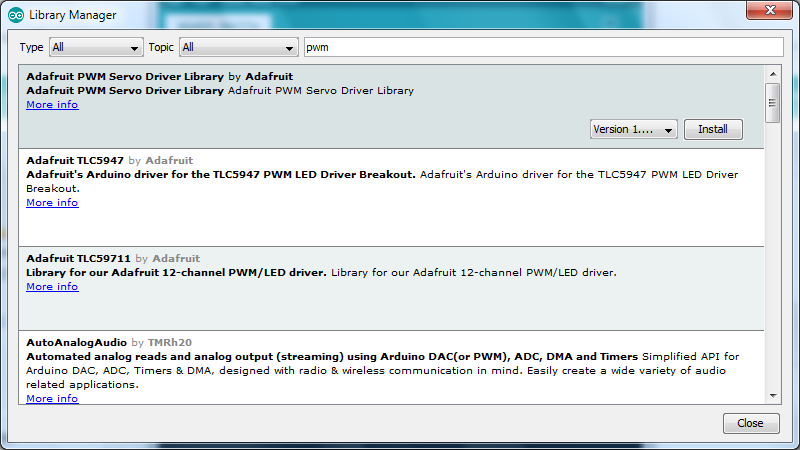

You need to add the Adafruit PWM Servo driver library. Go into the Library Manager and search for it.
Sketch --> Include Library -->Manage Libraries
Isaac96:
not working

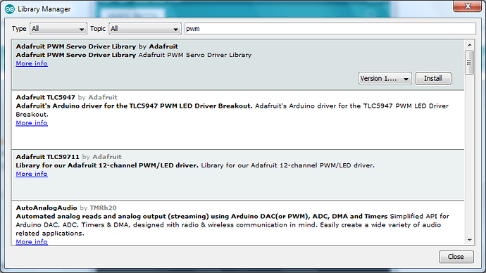

Here it is in the Library Manager window
Click "Install" and it should work.
