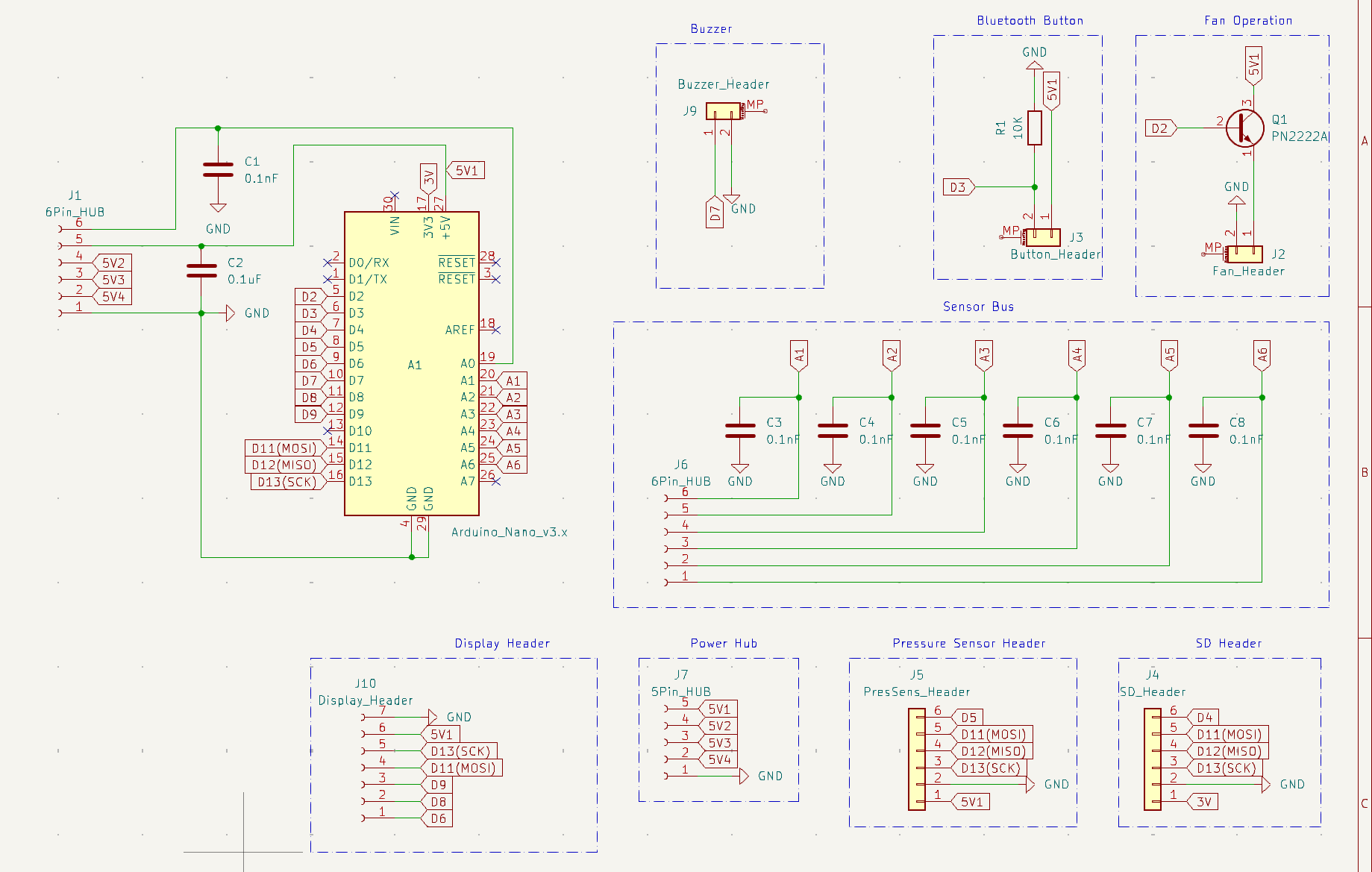

No short unfortunately haha. I plugged the rev2 into the setup and it worked fine so its got to be the PCB... Do you mind taking a quick looks at the schematic?
It is slightly different than the one you saw in the picture earlier but the differences do not affect the SD or sensor - just the display.
I think I see the problem.
You're powering the DPS310 with 5V. That should be 3.3V. Otherwise it's putting out a 5V signal on MISO and expecting 5V signals on /CS, SCK and MOSI.
From the Adafruit DPS310 page:
  • Vin - this is the power pin. Since the sensor chip uses 3 VDC, we have included a voltage regulator on board that will take 3-5VDC and safely convert it down. To power the board, give it the same power as the logic level of your microcontroller - e.g. for a 5V microcontroller like Arduino, use 5V
(and you may have a similar issue with the display being powered by 5V)
(and your button header is inputting 5V - is the Nano 33 BLE 5V tolerant?)
(and you're using an NPN transistor as a high side switch)
Got it thank you van! I was going to reprint this PCB anyway so thank you for the additional tips! Once I get it I will test and reply to this thread to let you know whether it worked or not.
And you don't have a base resistor on that transistor; ouch.

I redesigned the PCB with 3v for all devices and I am running into the same issue... I am kinda running out of ideas on what could be causing the problem here. I tested the components before PCB, I tested them individually on the PCB and they work great, but as soon as I plug in both, neither can initialize.
Sorry, but I've given you what ideas occurred to me. And I don't have a DPS310 to test with.
Thank you! I think maybe it has to do with my PCB traces and some weird cross-talk thing.
