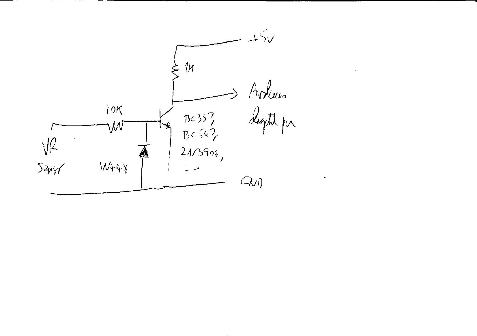

The problem with the zener solution is that 2.2v is not enough to drive a digital pin. I suggest the following circuit instead, which provides 5V to a digital input pin. You can then use frequency counter code and calculate the speed from that.
[EDIT: Note that the 10K resistor needs to be rated at 1W or more. Or you can use a 22K 0.5W resistor instead.]

Thanks for this detailed solution! I'm no EE, but I think this circuit does the following:
  • damp the waveform via the 10k R
  • bleed off negative voltages
  • use the transistor & 5V supply to make a 0-5V squarewave at the frequency of the original AC signal
    Have I got that right?
    Also, I don't think I'm reading your writing well - the diode in the circuit is W448? or??? I can't find a "W448" diode to buy... Alternately, how would you spec this diode performance for the circuit?
    Thanks!

You are both right. The 10K (or higher) resistor limits the base current to 10mA @ 100V input. The diode (I suggested type 1N4148 - sorry about my bad writing) provides a path for negative current, to avoid breakdown of the transistor base-emitter junction. The transistor amplifies and sharpens the signal to a 5V square wave.
dc42:
The diode provides a path for negative current, to avoid breakdown of the transistor base-emitter junction.
Ah, got it. I knew transistors had "built-in" diodes but I failed to take into account it's maximum reverse bias breakdown voltage rating -- just like any other diode. Thanks!

Modern transistors are typically rated at 5v absolute maximum reverse emitter-base voltage.

2N4401 would be OK, but a transistor with better hfe at low collector current would be preferred. What other NPN transistors can you source locally?

No, you need a smaller (i.e. lower current) transistor in that application. Look for one that has a good hfe at Ic=5mA or thereabouts.

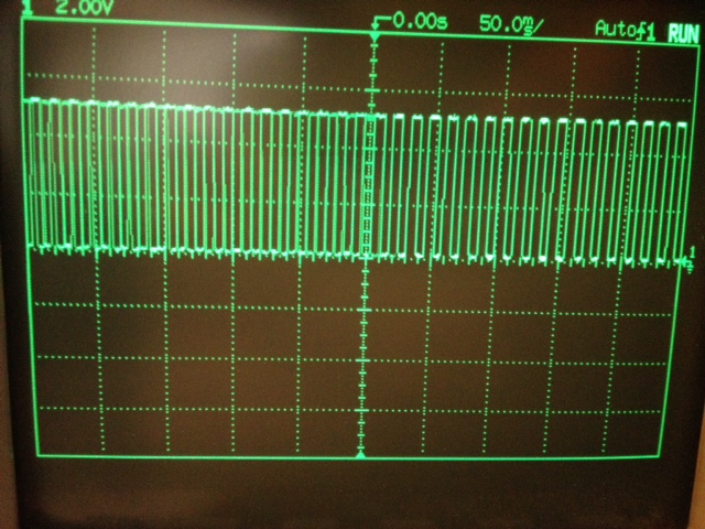

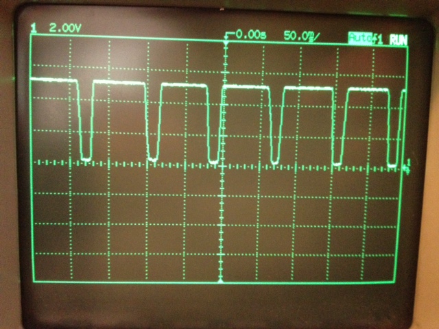

Well, very impressive! I got lucky on the parts, and was able to get a 2N3904 trans & 1N4148 diode. I had to substitute two parallel 22k 1/2watt resistors for the 10k. On the car, it worked GREAT! I took 'scope shots at ~3.5MPH & ~30MPH (I'm unwilling to spin the tires faster while on jackstands, or drive while looking at the 'scope in the passenger seat!). Unfortunately, I can't figure out how to paste the 'scope shots in to this note. Anyway, In both cases, there's a nice 0-5V squarewave, which I expect will work great with my Arduino code. Amazing what a few correctly placed (and spec'd) parts will do for you! Thanks, dc42 for your help!
As a side note, a comment about the amplitude of the signal: I stated originally that the frequency & amplitude of the raw signal was proportional to the rotation speed. While this is clearly true for the frequency, I'm not so sure it applies to the amplitude. I didn't go to the trouble of plotting a lot of datapoints, but I'm pretty sure the amplitude began to level off around +/-15V. An earlier comment suggested that simply rectifying & smoothing the voltage component of the signal might be easier. Because of this non-linear relationship, I don't think that idea would work. I note this in case someone digs up this thread in the future...
I'm glad you got it working! You will probably find that just one 22K resistor is sufficient. Regarding the amplitude leveling off as the speed increases, that may be due to the inductance of the sensor. What is the frequency at 30mph?

dc42:
To post a picture, click on the "Additional Options" link when posting or when modifying your existing post.
Ok, I think I got the 'scope shots posted this time. Interesting that the 'Insert Image' icon at the top doesn't work...
If I've got the math right, the ~30MPH frequency is 74Hz (~3.7 cycles in 50ms). Knowing that I've got 3 magnets around the output shaft, an axle ratio of 3.9, and tire circumference of 71inches, that works out to 25.5MPH.
I'll probably play around with other component values in the circuit later - if for no other reason than to learn a little more about what is going on in the circuit..
