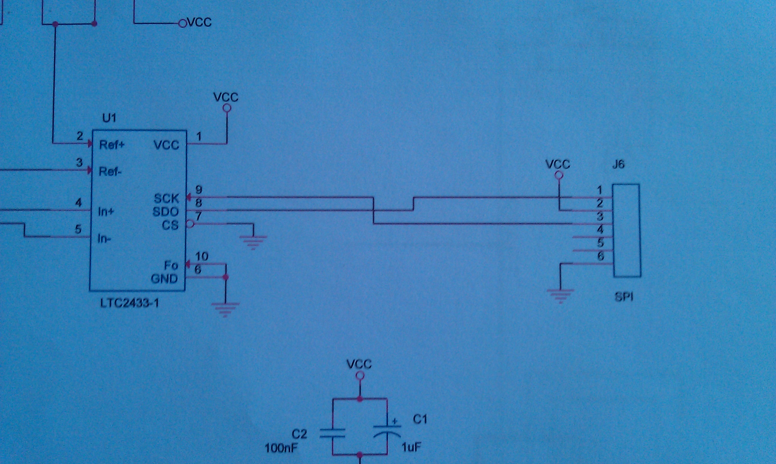

I have made a bord with a ADC LTC2433-1 connected to 4 strain gauge
http://cds.linear.com/docs/en/datasheet/24331fa.pdf
I use the SPI bus conected to a Leonardo
The CS is tied low because it is a prototype.
I cant understand the output, but I think the layout works.

I just saw you connected CS to GND. That way the chip does not know when to do a conversion and when to start a transmission. Take a look at the timing diagram on page 13 of the datasheet. The CS pin is needed in my reading of the datasheet.
I think you're right, but on page 15 is shown with CS to GND.
Change it on the job at tomorrow
Yes, but then you must monitor the DSO line for the EOC (End Of Conversion) state and you don't do that. I would even turn off SPI after each transfer, set PB3 to GPIO input, pull CS low and wait until PB3 gets low. Then activate SPI and read the bytes. Maybe it's easier to do that without the hardware SPI and use just the shiftIn() functions.

Perhaps I have found the error, there does not seem that there is a supplay for the 4 strain gauge.
If I put my fingers on the input I get the following
-20840
-18899
-11663
-13768
Now I've got it working :slight_smile:
There was no Vcc to the 4 strain gauge
