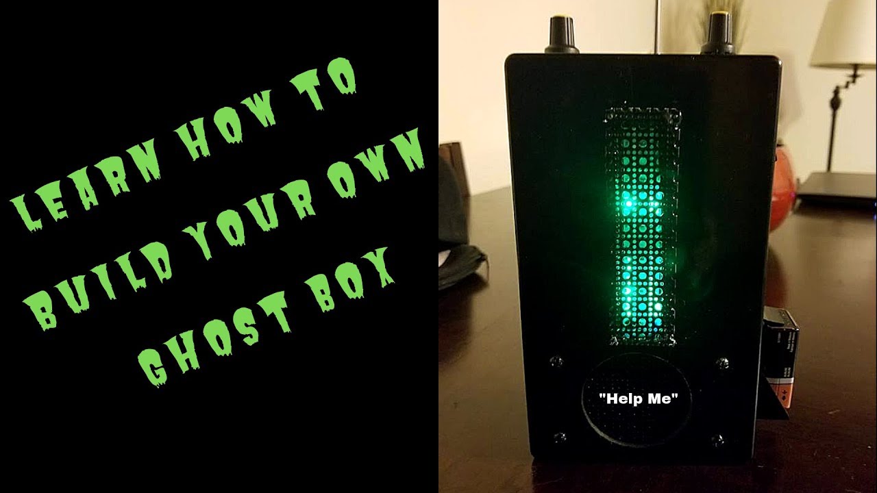

Here is the original video,
[![](https://europe1.discourse-cdn.com/arduino/original/4X/8/2/c/82caede696822f98de22d58089fa57a6a5e0fc24.jpeg "Build your own FM Scanning Ghost Box") ](https://www.youtube.com/watch?v=FUGD7NA2Jrw)
