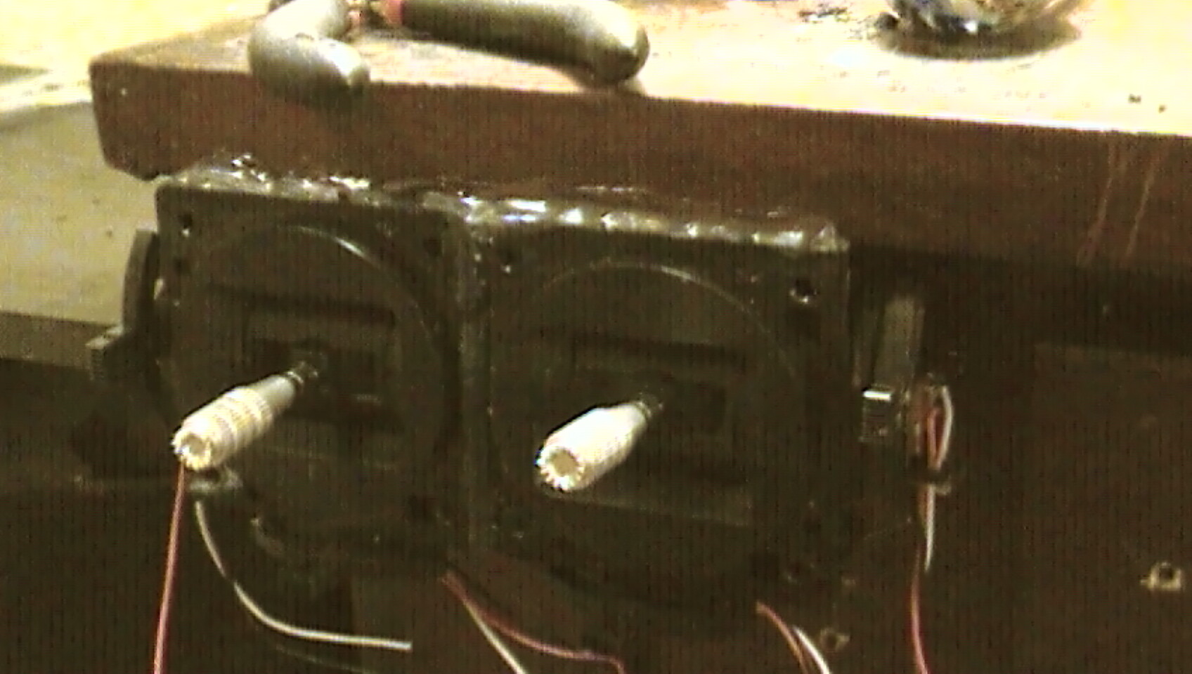

Hello,
I am trying to add the joysticks from an old 72mhz transmitter. I added 2 pix.
The problem I am having is when I get it plugged in to my Mega. The range is tiny.
I am thinking its the fact the the pots are different. If I remember correctly they are
50k. Here is the code I am running transmit side:

Find out the resistance of your joystics with a DMM.
The movement of the sticks will only be a small proportion of the total movement of th pot’s.
1.3 - 4.2k Serial Monitor says : 43 - 147 Thanks!
Perhaps the range is limited due to the trim tabs? I got the Serial output down to 12 by adjusting one of them.
jgreene33: Perhaps the range is limited due to the trim tabs? I got the Serial output down to 12 by adjusting one of them.
Yup, you guessed it.
Thank you for confirming that!
