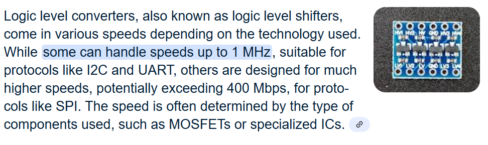

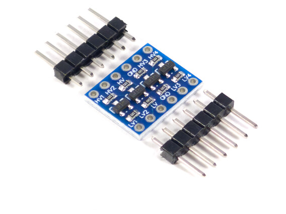

What about a Logic level converter on both ends?
Does use transistors but it is small fast and cheap.
How fast ? consider you need something in the order o 3.2 Mbps .
I can't find any specs on the suppliers sites.
You did mention 800khz in #post3.
This is all I could find.
Sorry @mikedb I'd be very surprised if a logic level converter will help. Voltage is not the main issue, frequency and the ability to drive a long piece of wire correctly are. Driving something like this requires impedance matching and something capable of charging and discharging the cable capacitance, I'd be very surprised if a level converter can do either of those things.

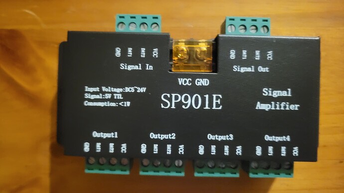

I found a solution to the issue by using this device. Thanks to all for the info.
Yes, that is correct. It drives it fine. It is not known whether or not it includes components that are found in the signal booster I purchased, but the completed T8000 does work out of the box.
A conduit is in place and cannot be snaked nor changed. I can only reuses the existing signal wire. And there is not place nor reason to bury a waterproof box. A solution has been found as indicated in my prior post that uses a signal booster at the point where the Arduino is installed. My application and use scenario is governed by strict rules by a manufacturer, ASTM, and county inspectors. There is no place or permission to modify the device on the receiving end. Yes, anything is possible. But modifying a concrete pour for a very large machine and structure that has been in place for decades is not an option. Instead, the solution used is simple and works. Thank you for your input.
