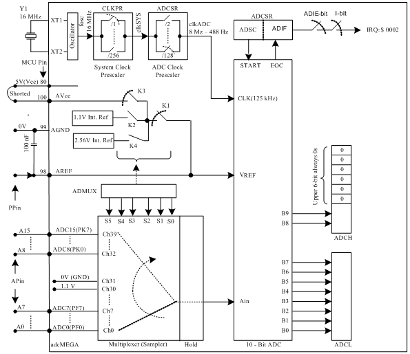

Yes, I'm using the ATmega2560 microcontroller. However, what's confusing me is the external capacitor at the AREF pin according to Figure-1 of GolamMustafa's reply.
I guess my question is, do I have to connect an additional capacitor to my AREF pin or do I just use the Internal 2.56V and the capacitor mentioned in the image is already soldered on the arduino board.
Thanks again for the replies.

And limited is a bit ambiguous, in every mode it can handle voltage up to Vcc (+ 0,5V) just fine. Output will only not rise above 1023 if passed VREF
Also note, you can't actually set VREF to 5V, you set it to Vcc which might not be exactly 5,000V. Which will then influence the reading. But the internal references are not super accurate as well.
The 100nF to AREF is already on the Arduino board. It is C3 in the schematic.
That 100nF is just a little optimization to reduce noise. When the internal 2.56V is selected, that voltage is also on the AREF pin. You can measure the 2.56V with a voltage meter. The 100nF only reduces some noise. The value of 100nF is just a nice value because 100nF is used for decades to reduce digital noise, it does not have to be 100nF.
When there is no 100nF connected to AREF and the average of many samples is taken in software, then the result is about the same.
septillion:
Yes! I note it down. The AVcc-pin (Pin-100) of ATmega2650 is shorted by the MEGA Board with 5V (Pin-80, 61, 32, 10). So, AVcc is dynamically changing with Vcc supply. I am posting below the amended diagram.
